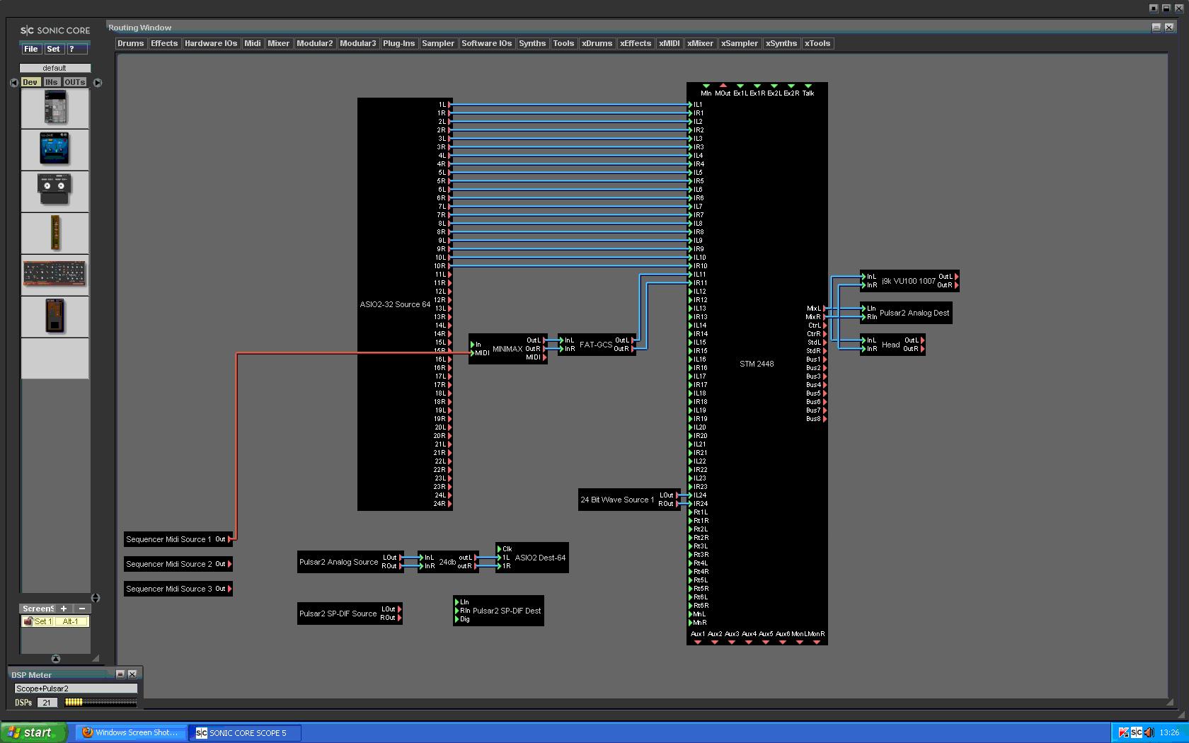

The easiest way to think of Scope is as a hardware mixer - it's much more than that but it's a good starting point. So Scope 'sits in the background' as it were and you then launch Cubase (you have to have the right ASIO modules and number of ASIO channels set up in Scope first). Now buss all your individual Cubase channels (including VST instruments) to the Scope mixer, and then the stereo output of the Scope mixer can go to your monitoring and also back to Cubase when you want to record a final stereo master. You can add whatever Scope synths and effects you want here.
So all you do is flip between the two windows. You can use any combination of Cubase VSTi plug-ins and Scope plug-ins in any routing combination imaginable (or even not yet imagined) - it's completely flexible. Although Scope has a very good recorder (VDAT) it is more of a live player tool as there is no sequencer.
Scope Ex1.JPG (157.72 KiB) Viewed 3655 times
So in the above example I have 24 stereo ASIO Source channels coming from Cubase. The first ten are going into the Scope mixer. I have also added the Minimax synth and decided to put that through space f's FAT module before going into Channel 11 of the Scope mixer. That whole mix is going to my monitoring (plus some meters). When I'm ready I would route it into the ASIO Dest module to go back to Cubase. The Sequencer MIDI Source is Cubase's MIDI output and is driving Minimax. This is all in addition to whatever you normally do in Cubase: you lose nothing but add much functionality.
