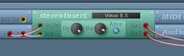

best solution for parallel compression in scope
- parallel.jpg (15.03 KiB) Viewed 5283 times
