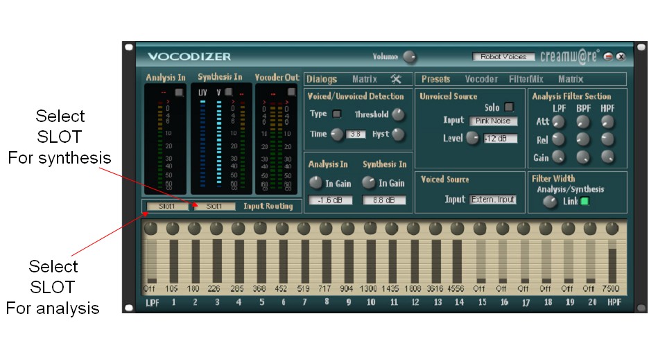

Hoping someone can help. I'm getting frustrated trying to get the vocodiser on my Noah ex to work,
Could anyone run through how to set up the vocodiser using an internal or external signal as I have no manual and I am really struggling with it?

You can download the manual on sonicore FTP site:
ftp://sonic-core.net/manuals/Noah/
NOAH Vocodizer sources selection.jpg (105.94 KiB) Viewed 3144 times
