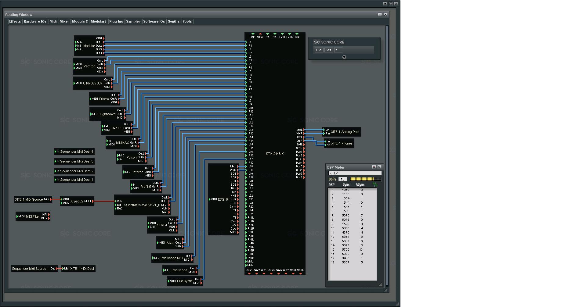

This demonstrates the ease of use XITE-1 is when the loads are thought out in advance.
I am using 3 x Synths that span across DSP's. And it's a large template with QWave, Prowave, 2 x XOR's, B2003, the SpaceF MultiSynth using 3 x MIDI Channels, 4 x Modulars and SpaceF's MiniHost.
I can load up tons of stuff as long as I know which synths are spanning DSP's, and make sure when I load the project those synths are set at their maximum voices prior to spanning.
QWave is 4 voices, and the same with Prowave, so once loaded I raise their polyphony to 6.
Then I go to SpaceF's MultiSynth and raise the polyphony on 2 of the synths to their needed levels which is 4 voices on 2 x parts and mono bass on the 3rd.
2 weeks ago I couldn't even use MultiSynth, thanks to SC & Ralf D., the SpaceF stuff is now starting to be added to my projects.
The Legacy MiniHost synth shell is packed w/ RDII, Flexor & SpaceF Satellites too.
I have everything I need as far as effects go in the Mixer, but I am going to start experimenting with effects and the mixer now just to see how far I can go.
It's sure a nice day in XITE-1 world.......... :D I still have 3 x unused DSP's and room for more stuff on 5 DSP's. Pretty serious loads for 50%.

Here's what I think I will be using instead of the big Multisynth WS4-MKII.
Serenity & Volcano, which are both WS2's.
The advantage is easier placemnet and loading, plus I can use my 2 x Analog rackmounts.
One for Bass and one for lead, and then the 2 WS2's would be 2, 2 part layers on the keyboards. The fact I have 6 x Lfo's on each WS2 and have the MB4-II and both synths hooked up w/ the Panel connectors is just classy.
I can have my mixer in the window,and then call up either synth by hitting panel 1/2 or 3.
When the DSP meter starts to edge it's way near the 90% mark, that is when we we be fully optimized. I am still running into trouble around 55-60%. But still I am loading way more than I can possibly use live. But it's great to have QWave, Prowave and a MiniHost just hanging out waiting to be used.

Here's my mondo synth project so far. Most synths have 5 voices.

Here's the SpaceF FP106C vrs. 1.6 with all the effects I need.
Each channel has a FAT Valve effect or it's own 5 band EQ.
then I use the AUX Delay, and 2 x different Reverbs on the AUX's.
Each AUX has 2 inserts which I use for EQ's along with the reverbs, and a chorus for the Delay.
Then all channels can be modulated/panned/filtered w/ Mehdi's 3LFO and LFO EF devices.
2 x seperate MIDI channels to control inserts,
and one for the surface which is vast combinations of sub presets and controls.
A rather incredible Live mixer.
All mixers seem to like DSP #8 now since the last upgrade.

I decided to not give up with different combinarions of loads, and I have created some extreme results, that are repeatable.
I load up a mixer, w/o effects, then the B2003 or an XOR or any synth that uses 2300-3500 using it's default settings.
Then I add the mixers effects and keep it on a single chip.
Then load Prowave or QWave SE and it loads in on chip #16.
I then assign it to # 18 while it is low in poly.
Once it is on #18 I un-assign ( clear ) it and start adding polyphony.
It doesn't span DSP's but rather loads and loads and loads.
I have 7 voices on a single chip, and I am using Osciallator Pairs and Custom Filters too.
Take a look at these numbers and see if you can repeat this on your XITE-1 using synths w/ the same DSP needs. For Prowave I would use a large Modular Patch or Atze, but I can't get Atze to do more than 3 voices before it causes troubles, but it is a big hungry beast.
Anyway I can repeat this process over and over.
I just want to see if similar numbers can be reached on other XBox's.
