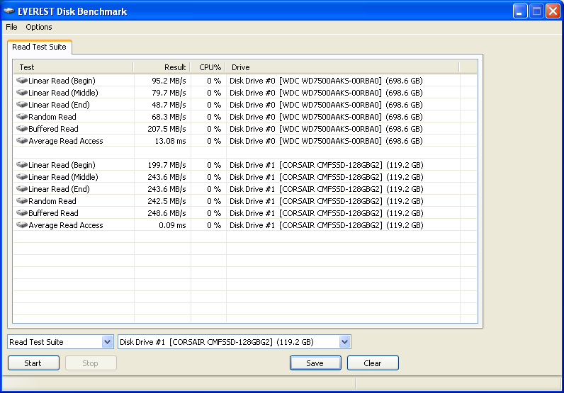

I just installed a SSD as my main drive, and I love it. The speed is great, multiple times faster than a hard drive. But the reason I sprung for one is that I do a lot of sofware development, which means I crash a lot - and loosing the data on the HD can sometimes be a serious problem. I back up frequently of course, but in the heat of a programming marathon, I sometimes forget. Same deal with studio work - it's hard to remember to stop and back up when the muses are giving you a ride.
But with a SSD, a disk crash does not mean you've lost the data. It only means you can't write to it anymore. So to recover you just put in a different boot drive, and read off the SSD data. It's a whole new ball game.
There are issues, of course. A lot of the low priced SSDs use a sub par controller, which causes stuttering - disk write times of a half second or so. There is a general problem in that they all read and write in small (usually 4K) blocks, but to erase they have to do a 512k page. So writes slow down after a while in all of them. The Intel SSDs, and the later Samsung based SSDs like the Corsair P128 (the one I got) have an processor and lots of buffer and do smart "erase-defrag" which greatly minimizes the problem. So far my Corsair P128 is doing fine.

Re: Worth The Wait
Coolness........does it use the Intellilink..?
Those are impressive reads. I have been told for live work I won't use more than 50-65 MB's per second, but I know when I start packing on VSTi sample playing instruments for seqeuncing and recording this will skyrocket. 280MB's per second seem like a dozen powerful romplers.
