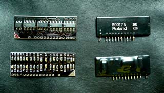

It actually is a custom Roland module, which does both the filter & VCA (from the article, it's the amp part that usually goes south):
				- v7_withoriginal.jpg (47.1 KiB) Viewed 5137 times
