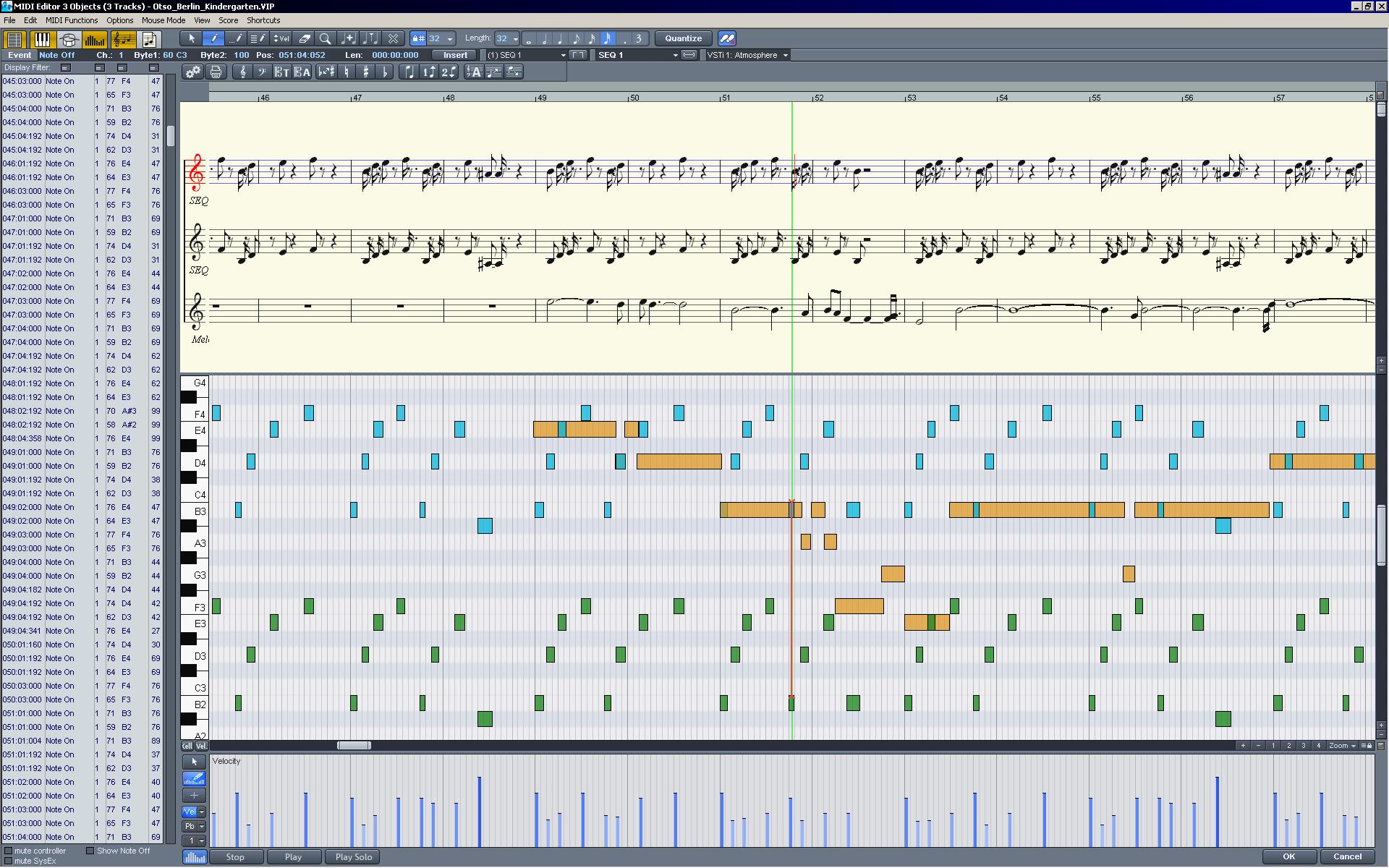

Re: Reaper Continues
Here's the Score and MIDI editor in Samplitude (unfinished, raw capture).
By the way, as you know, with Scope it's possible to mix through Samplitude into a second instance of Samplitude to effectively capture/mix 'outside the box', while working 'inside the box'.
I'm getting very good results this way.
