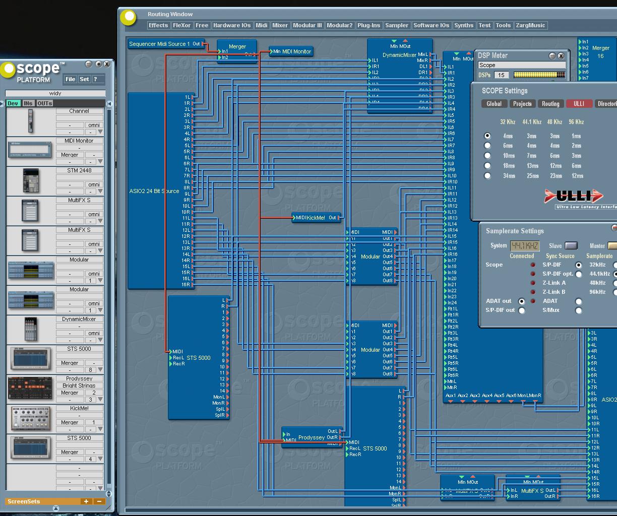

Re: new pc hw setup
hi
just one at the moment
had 2 cards (2x15) years algo but always pc bus overflow on my old pc ( the second last ) ....
but i think about to buy a second one or maybe i should wait for exite .... i dont know right at the moment ....
but my current setup runs perfect ( see setup 2 two posts before )
-no crash
-better timing than with my old one
guru as drum sequencer and also play midi drums with scope ; can not realy hear a timing problem
- with vst und 2 sts 5000
- 4 master verb pro as insert
- one external effect in cubase routed via asio in and out
see pic
cheers widy
-no crash
see pic
cheers widy
- test.JPG (239.04 KiB) Viewed 1692 times
lg widy
