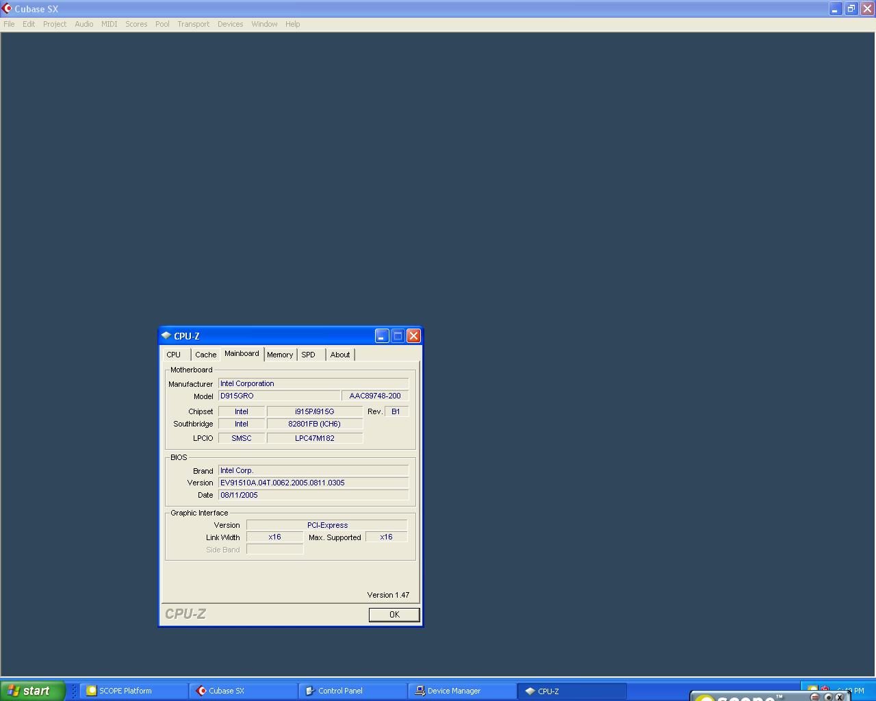

on my computer the 2 cards are on 2 different irq channels(pci 21 and pci 22). theres only 2 pci slots and i tryed switching the cards, didnt work. heres a screenshot of my motherboard info

915 made problems with the original Pulsar, though it should work slaved to a newer board.
I wouldn't waste a minute but sack it - if I remember correctly I paid just 50 bucks for a Gigabyte 946 which runs flawless with the old cards. I have to know because I have only old Pulsar Ones :D
