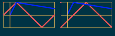

it could be because at that low frequency the free running oscillators are at different positions in their cycle when the envelope attacks.
for instance the time period of 50hz is 20 ms so say a quarter of that for the rising of the wave from zero to max, is 5ms. if your attack is at 2ms you will still have a 5ms attack instead. worst case scenario with a narrow pulse oscillator would be almost the full 20ms late!
if you use an LFO as an oscillator you can make it start on the envelope trigger, and also you can change the start phase, which might give more tweakability to your drum.
heres a little pic. the blue is the envelope and the red is the wave(i used a triangle wave due to lazines

Re: envelope attack not consistent
Thanks, I was wondering if this was the problem and I even thought that it'd be good to have the osc trigger new at each gate but I didn't think of using an lfo, I'll try that. It was the only thing I could think of and the problem is really only very slightly noticeable at higher freq's, the higher is the better response.
