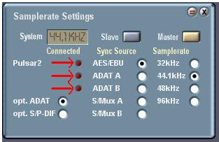

Playing a song in nuendo 3.2., suddenly the samplerrate changed from 44.1 to another samplerrate wich i could not recognized. All wave files sounded pitched higher.
When i played wave files in the windows media player - the same problem.
The scope samplerrate settings were still 44.1, and the three red points were blinking! (Look at the bitmap file)

i would first try re-seating the cards in your computer to see if that helps. If it doesn't then try some contact cleaner on the connectors (be careful what type you buy - some make things worse). If you have more than one card try giving the STDM connectors a bit of a wiggle too.
