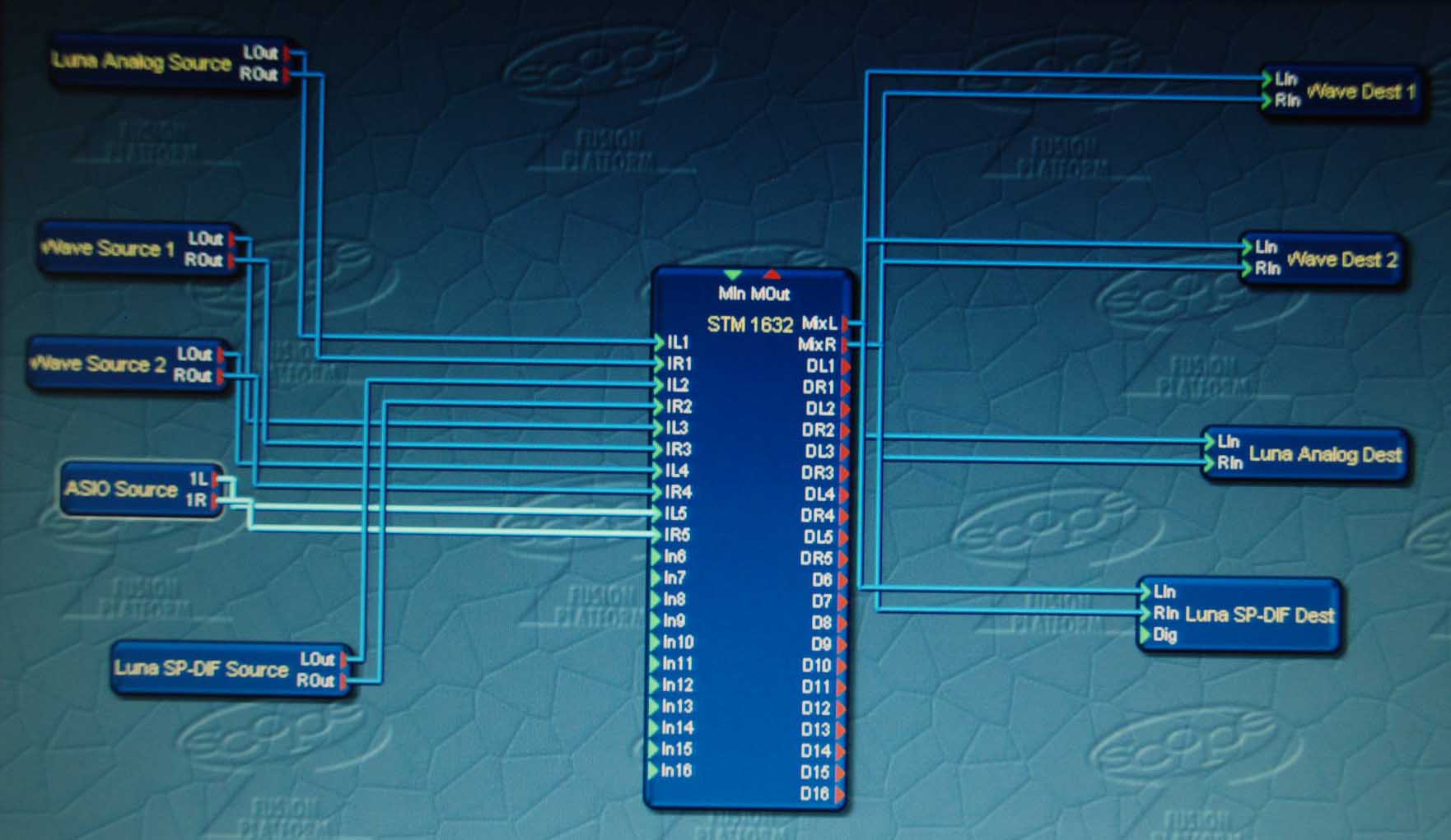

Strattosphere
Posts: 56
Joined: Tue Feb 24, 2004 4:00 pm
Location: Northampton, UK
Post by Strattosphere »
The 01X is Yamaha's mLan mixer/interface/control surface that uses the mLan Firewire style interface. I'm not convinced that there is an ADAT option, but it does have SPDIF and Optical for 2 channel i/o. You can connect the 01X to the Luna via the SPDIF input then use the Scope SP-DIF source routed to an ASIO2 destination into Cubase. You'll only be able to record 2 channels at a time as the19thbear said.
Stratt
Here's an example of what should work

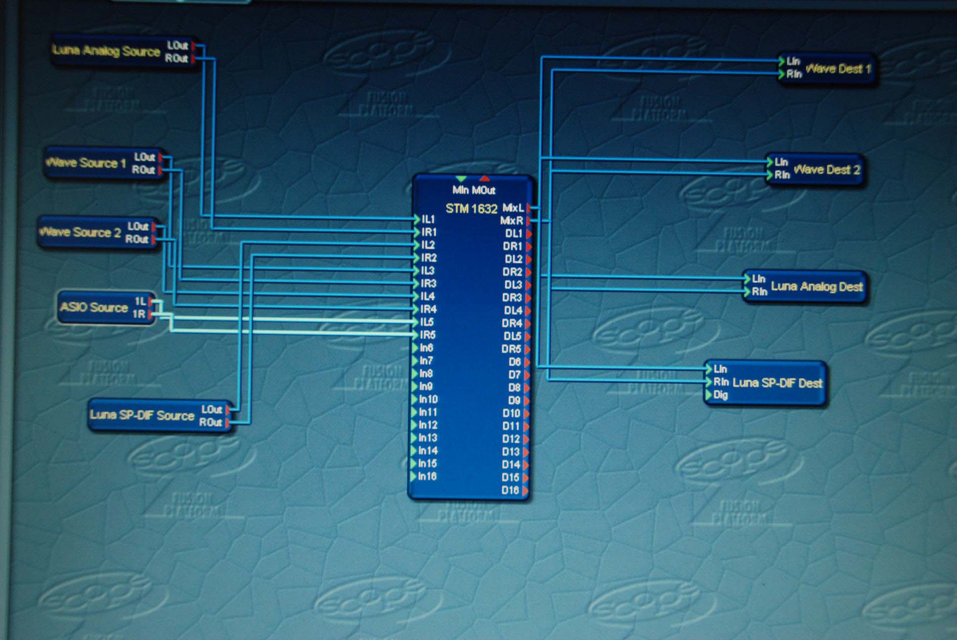

Hi
Here is a screen shot
Which ASIO module is the Yamaha 01x , knowing that i am using the digital in/out of the Yamaha into the scope. Cubase and other sound is playing back from the computer into the mixer out thorought the monitors.
But i cannot record into cubase
ark
Posts: 20
Joined: Sun Jun 08, 2008 3:08 am
Post by ark »
sorry to big
Posts: 23380
the asio modules are the i/o JACKS for your sequencer.
they must be in the routing window with the proper number of ports before opening cubase.
