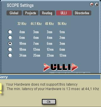

Hi all,
I have the following computer configuration:
CPU Athlon 2700+
MSI Motherboard
1GB DDR RAM
2x200 Go SATA HDD with RAID1 (400Go)
1 ATI Radeon 9600 series video card
1 Scope Professional 15 DSP audio card
1 Firewire TC Electronic Konnekt 24d audio card
(Firewire, RAID and Gigabit controllers included in mainboard)
I have the following problem:
I can't setup ULLI to go under 13ms at 44.1KHz. I have the message:
"Your hardware does not support this latency. The min. latency of your hardware is 13 msec at 44.1 Khz"
Would it possible that a Scope pro board couldn't function with lower latencies than 13ms and 44.1?? Anybody did hear about series of Pro cards acting like that? I'm asking as I bought it 2nd hand on eBay during August 2007 but been sent back to sonicCore for a repair during september...
If anybody could tell me if it's a possibility or not, than a Scope Professionnal board couldn't have lower latency than 44.1 - 13ms...
Denis

well, I also have a few first generation cards.
I don't mind the latency as I monitor before the tracks and there's no time critical VST stuff for me.
But my A100 and P100 reverbs suffer from the lower PCI bandwidth, cant' use them together (the Ambient is the heavyweight).
My PCI bandwidth test result is 5 Masterverbs - a 2nd generation card would increase this to 10.
I'd prefer a Scope Project, since the 3 DSP cards have been reported to be more 'difficult' in some setups, for whatever reason.

no, the PCI latency timer just sets the maximum unit a device can hog the bus (in my humble understanding)
since I have only 1st generation cards I've tweaked it up and down various chipsets, Intel 815 leading with 5 (active and connected) Masterverbs.
Chipset and interrupt configuration had a larger influence than the latency timer, but actually it concerns only a very small number of systems.
my rule of thumb from the Masterverb test thread
1st generation card (ULLI not possible below 10 ms) is 100%
a (additional) 2nd generation card will double the PCI performance
2nd generation only cards would add another 30% improvement
