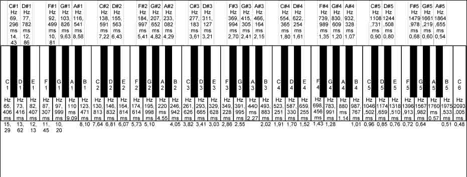

arela wrote:
From my calcs - there is A at 110 and at 55Hz so somwhere in between, maybe a E0 or F0?
Just in the hope I understood what you're looking for.
I'm not sure MIDI note numbers are correct. If not, do advertise me and i''ll 'update' my sheets. If anyone would add MIDI notes sequential numbers, or tell me which is the correspondence I'll be very thankful.
Millisec values represent single wave cycle durations.
FREQUENZE DELLE NOTE.xls
(24.5 KiB) Downloaded 126 times
Cochise
Posts: 1305
Post by Cochise »
Sorry, you should shift the three columns of calculations some row down in the Xls, then copy and past up twice the values of the first row to obtain 55 Hz.
(Similar thing can be done with upper notes).
It should be A0.
Frequency doubles each octave... :D
=Added=
However, even using semitone cent tuning, the closer value is 85,018 Hz (F - 46 cent or E + 54 cent ).
But table and calculation sheet might be otherwise useful

Thanks Cochise, this is useful.
I generated a 85Hz signal with Audition1.5.
Easy to get confused with this stuff, because a bass generated with Band in the Box is often to low to use without transpose up one octave.
