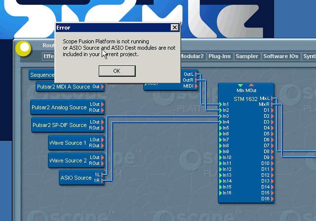

Which ASIO driver should I use with Bidule? I've tried "ASIO Source," "ASIO 24-bit Source" and a few others. Thanks.

i use the asio2 24bit source and asio2 dest, but any proper pair would work.
bidule is a little tricky to make work the first time. after that it's easy. if bidule(or any asio host) crashes, it will hold on the the asio driver which will not be available again before reboot. this is because of the way that asio functions making, as it were, a locked connection between hardware and software. this is the purpose of the "release driver in backround" function on steinberg apps allowing more than one app to use the asio driver, but i suspect you know all this.
the first time with scope, open bidule, remove the default bidules and put the creamware bidules(asio scope duplex and creamware midi) and then make this the default project(edit/makedefault project). restart bidule and everything should work. i've found that if bidule starts with the default modules which access systems that won't be available with a scope card, bidule disables all it's ports, bother. after making the default project with available ports, everything seems to work great from then on.
sorry if i went into more detail than needed or told you things you already know, i just felt like typing for a change....
btw- just in case..the proper modules for bidule(sequencer midi source and dest, and asio source and dest) must be in your scope project with the proper number of i/o channels before opening bidule!

I finally had to save a blank Bidule project as my default. Now it seems to work, thanks.open bidule, remove the default bidules and put the creamware bidules(asio scope duplex and creamware midi) and then make this the default project(edit/makedefault project). restart bidule and everything should work.
