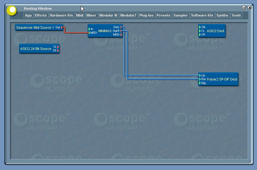

Setup attached. It worked before, it's my autoload or whatever Scope calls it.
Posts: 23474
try adding a sequencer midi dest as well. (there's none in this screen shot)
i assume midi is coming from a usb interface to midiox to scope?

is there still no sequencer midi dest in the project?(it needs to be there BEFORE opening midiox) :D

garyb wrote:is there still no sequencer midi dest in the project?(it needs to be there BEFORE opening midiox) :D
