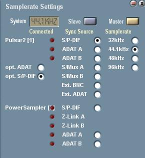

did you try to make sure that the cable from the expansion plate is still well connected after you add the pulsar.
as adding another card should not make a plate disappear. that is strange
did you try reinstalling the software so it detect All I/O
you should see something like this
