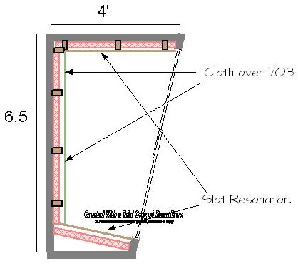

the vocal booth thing is so that you can isolate the singer while the band plays live. otherwise a seperate booth isn't needed. if a booth is used, it's important to eliminate reflections from the walls are much as possible(foam). a dead space never sounds as good as a properly treated reflective, but diffused room. if you have the space for two rooms, great! if you can only have one big room, that'll work too, it just means that you'll be doing a lot of tracking with headphones on the engineer and the artist, instead of just on the artist...
by all means read the info on those websites, the acoustic treatments don't need to be super expensive if you get the principle.

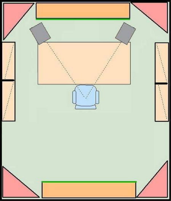

Here are a few bits of information I’ve collected along the way that you may find interesting (for a control room):
• Monitors should NOT sit on the console but behind, placed on heavy decoupled stands - console placement causes early reflection problems in most cases, unless the console is slanted down in front a LOT.
• Distance to wall behind speakers will change response drastically - there is a wall bounce calculator on the Acoustics forum that's fun to play with (needs Excel)
• Moving either speakers or your head by as little as an inch or two can sometimes make drastic changes in response, due to modal peaks and dips.
• Left/right room symmetry (at least within a foot or two of ear height) is important for good stereo imaging.
• Roughly 38% of total room length from the front wall
• Equilateral triangle formed by left, right mix position
• Monitor angles 60 degrees
• Monitor height – woofer at ear level (avoid mid point of floor to ceiling measurement – either sit higher or lower if necessary)
• Angled side absorption panels – left/right of mix position
how to build a vocal booth:
http://www.johnlsayers.com/phpBB2/viewtopic.php?p=51632
iso/vocal booth
iso/vocal booth
how to treat a rectangular room (red: basstrap, else slot resonator, green: broadband absorber covered with cloth
