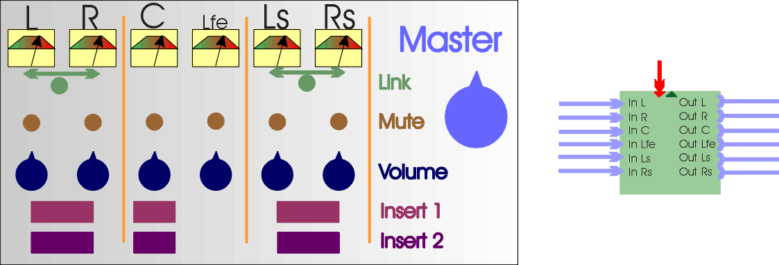

I would love to see something like this.
Don't even think it's nessessery to be able to unlink front and rear chanels.
Inserts are not a must, i just had some free space :-)
(but it's a + if it's done without much inconvenience)
At last i draw this wonderfull device, but its a minus<br />.....it don't work !
Surround controller.gif (52.52 KiB) Viewed 4159 times

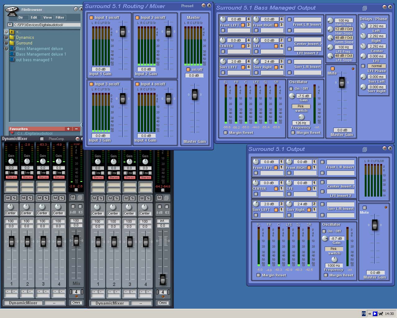

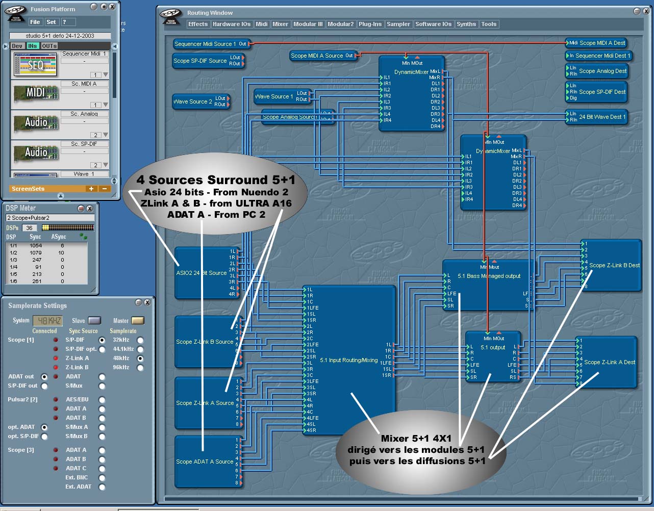

sonolive
Posts: 561
Location: Digital AudioSoft
Post by sonolive »
hi arela ,
i have already build all you need, and more ...
have a look
cheers olive
routing window
routing window
projet studio 5+1 - stéréo.jpg (242.33 KiB) Viewed 4097 times
gui's
gui's
devices projet studio 5+1 - stéréo.jpg (271.25 KiB) Viewed 4098 times
arela
Posts: 858
Location: Norway
Post by arela »
hi olive

sonolive
Posts: 561
Post by sonolive »
hi arela,
these devices are very old and on the way to be optimised ...
will be sold as a bundle, in fact the most important of them is the Bass management, you will absolutely need one if you plan to work 5.1 ...
cheers
olive
