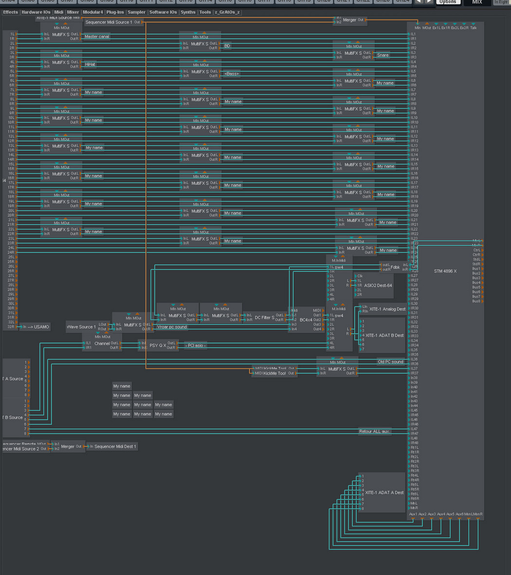

dawman wrote:Anyone care to share a newly skinned project window?
I need to be tormented.
How’s the XITE-1 working with new resource management?
Any new modules?
But aren't you on earth ??
New colors in the project window :
Scope 7.0 is the most stable / Xite dsp friend version ever ! There are still some improvements to do but it's worth it !
Any new modules?
I wonder if you can remove the multi fx in front of the mixer now due to v7?
Re: Scope 7
Liquid EDGE wrote:I wonder if you can remove the multi fx in front of the mixer now due to v7?
You mean all inserts I use inside the STM ? Well... I'm quiet sure that even with Scope 57.0 (like firefox !) , it will be much more good for dsp's power to do like that.
I think it distributes better on each dsp the load than all in only one device. Moreover, I use to have the 2 multifx you see before the DC filter in which there is my mastering chain (reday for when the project is finishing but muted before) , one inside the second and it is what crashed Scope 7 when loading.
After having separate them, I get back some dsp's power. And nomore crash. I'm very satisfy by Scope 7 : it is good for Xite-1 dsp's ! It seems to have even more power than with 5.1 !
Interesting. Yeah was just wondering if v7 greatly improves dsp spread regardless of one device or many.
Partly why I got mod mixer v2 to do the same sort of thing, it still “feels” weird to me having fx stacked up outside the mixer before the trim.
Re: Scope 7
Liquid EDGE wrote: it still “feels” weird to me having fx stacked up outside the mixer before the trim.
Yes, I noticed that on the video ! You've got all in the mixer ! The way I did first when I had my Xite-1 unit.
But have a try ! You'll see how many power you'll have more ! It's just a habit to get and it gives you more wiring possibilities.
I'm not sure if Xite dsp architecture allows to share all 18 dsp's power in one big device. I don't think so, whatever the way the sofware is builded. But I could be wrong !
