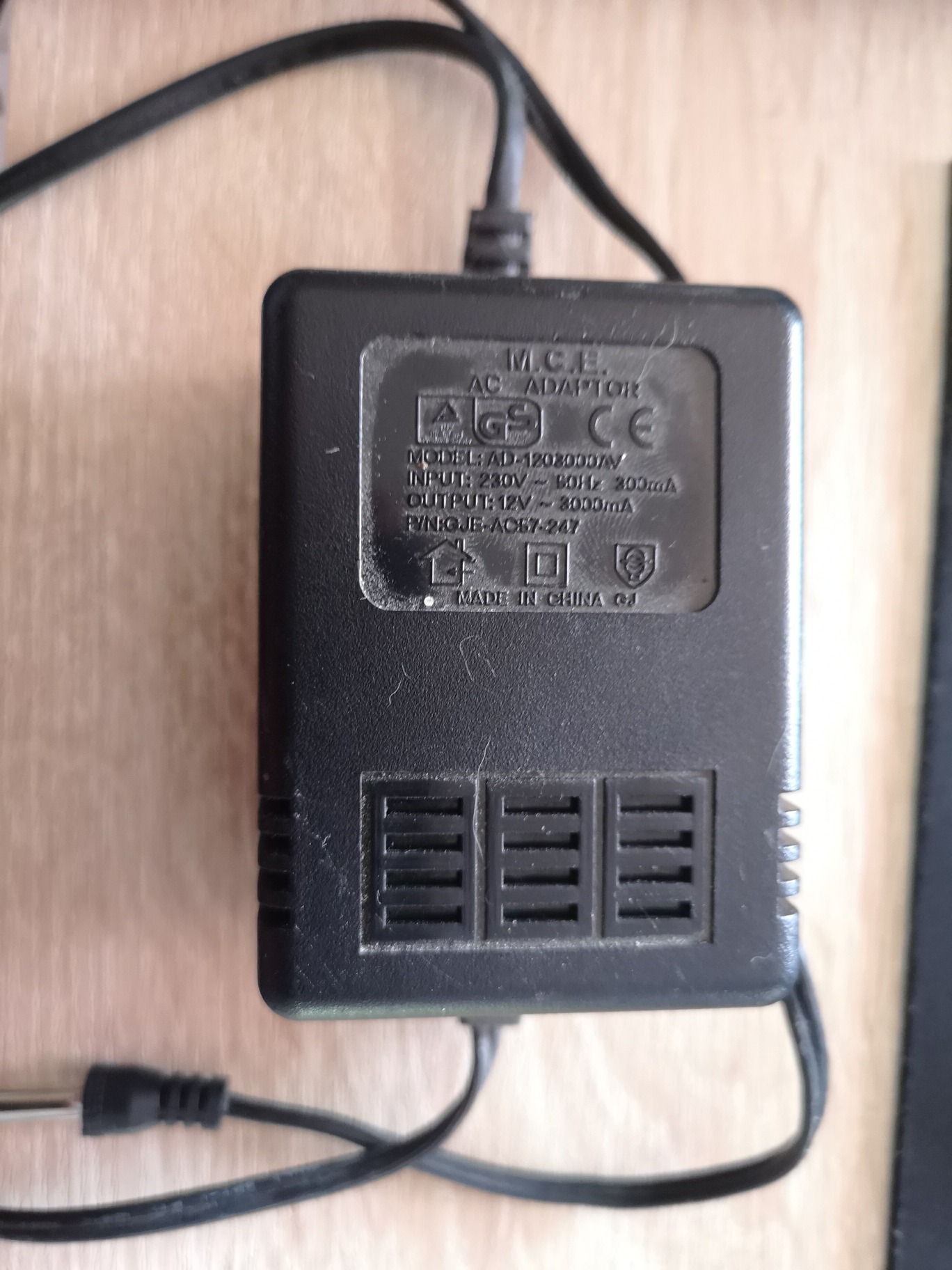

After checking everything, and before throwing away my A16 ;)
As I bought it second hand, is it the original power supply, if not which power supply do you advise me to use?

Re: My A16 Ultra's going to trash..
that should work, i believe. did you put a meter on it?

Post by Strictly East »
14/15v but not stable
Strictly East wrote: Thu Apr 16, 2020 2:04 am ... is it the original power supply, if not which power supply do you advise me to use?
Original or not doesn´t matter.
For A16U you need output AC 12V / 1.5A.
For my S|C "blackface" A16U I have AC 12V 1.6A and for my CW A16U there´s a much more bulky AC 12V / 3.5A.
Both work.

Posts: 8466
Bud Weiser wrote: Fri Apr 17, 2020 4:08 pm
Both work.
An AC powersupply is just a transformer within an enclosure.
To deliver the required voltage during regular load conditions, the transformer's unloaded output voltage is higher than printed specs because voltage will drop under load.
Considering the current difference the S|C and CW A16Us may have different designs.
With a 'bigger' than required PSU internal voltage regulation will have to work harder, which is not a problem, but it will produce more heat and may age (in particular) capacitors faster.
(this does NOT apply to switching PSUs)
