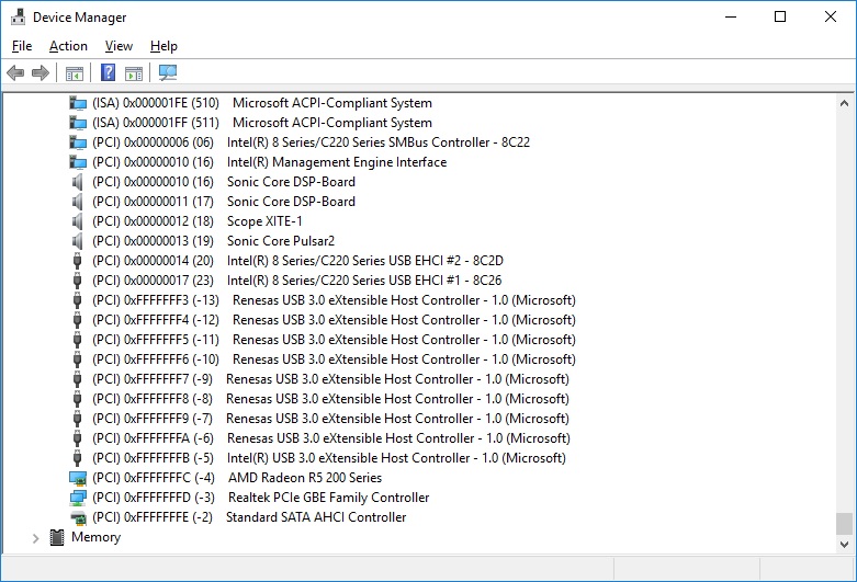

Yes, so we have yet to reduce this to a unique set of (reproducible) conditions. We only know that there are 2 conditions (Scope 7 and Show Desktop) but there may be 1 or more. We know the following :
1) its not OS specific (happens on both Win 8 and Win10).
2) I doubt its related to a C++ Runtime version conflict, because I uninstalled ALL versions of C++ runtime and Scope still worked and the error still occured. Same after I used to Scope 7 installer to re-install the C++ runtime.
3) Its not Scope hardware type related (happens on both PCI and XITE)
Unknown factors include :
1) Does it happen on 32 bit systems ?
2) Specific hardware conditions such as IRQ conflicts, video card etc.
But the fact it relates to 'show desktop' or 'hide desktop' suggests to me it could be video related, although that would be a lot easier conclusion if it were reversed. EG 'Show Desktop' crashes rather than 'Hide Desktop'. ...
Anything weird in my IRQ ?
Dante IRQ
Dante IRQ

Posted: Sun Dec 24, 2017 2:51 pm
by garyb
no, nothing weird.
it really does not happen here. not at all.
