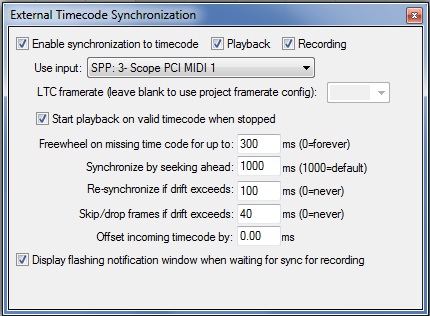

Reaper is then told to pickup its clock from MIDI dest 1, and let PTC control it:
Now, pressing space with the PTC window active fires it all up, with a "stabelish" clock.

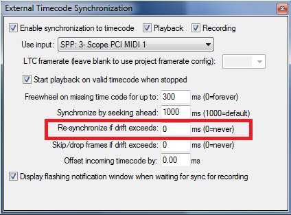

In example, i just upped PTC tempo to 185bpm (Scope reports approx 205), which made reaper jump and skip until i changed some (obvious) configuration:
