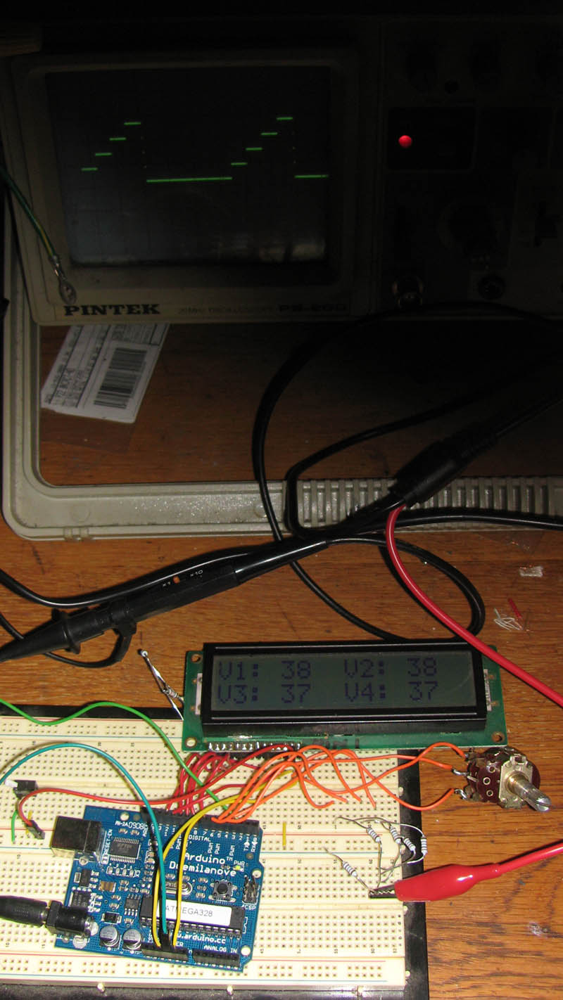

The hardware consists of an arduino microcontroller board and a few other chips, and possibly an LCD to give feedback of what it is recieving.

Here is the trigger outputs being tested at 1 khz. very stable.
Capacitor is doing 8 steps per cycle but i think we can at least use the same scope device to control it.

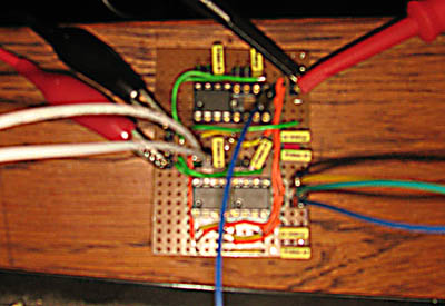

i have built the 4x sample and hold board today and tested it.
sorry for crappy cel phone pic, battery was flat in the camera!

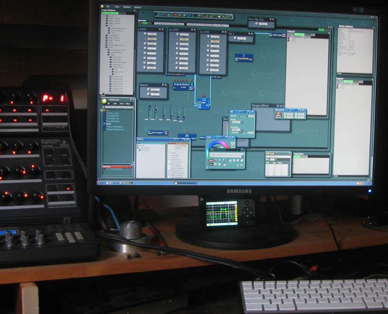

and started on the scope device. the little scope comes in very handy!
basically what i need to make is a 6 way rotor.
