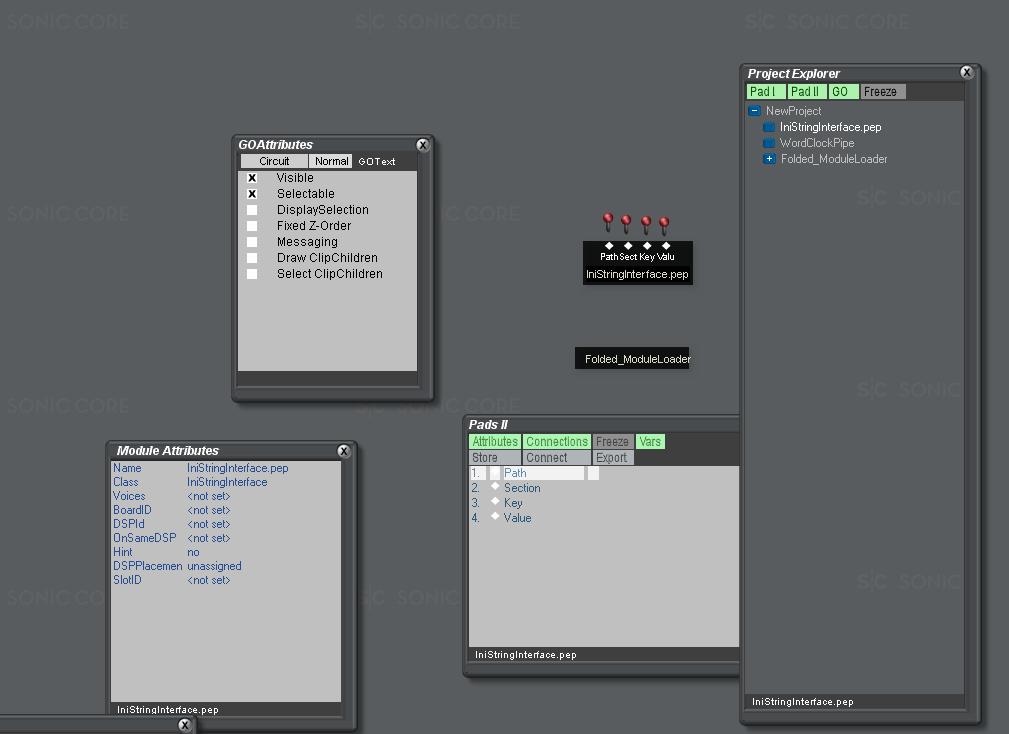

OK, I was able to enter the filename into the array and got the pep loaded. After that, I could drag out the interface (in Project Explorer) and add some GO (like frame, text) to it. But I can see the module in the circuit design only after clicking 'create circuit representation'. I also can see 'read' and 'write' menu options, but they don't do anything.As it turns out, the pep file is still within the loader, even the project explorer says otherwise. Question now: how can I separate module loader and pep with mouse?
I see this:
Re: Any way to save presets in modular 2
Posted: Sat Sep 03, 2016 4:10 am
by sharc
After dragging IniStringInterface.pep out of the ModuleLoader rename it to IniStringInterface and save it as a .mdl.
You can now load this module and set the path field for the location of your text file.
Check out the cset.ini in notepad to see the format of Section and Key entries or simply enter them in the PadList, set the path and then choose write to update the text file with the correct formatting.
...Value is the string which will show for the key.

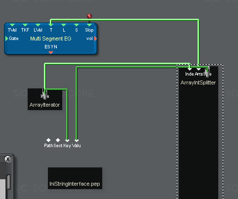

Netx question: how can I connect the value with the EG? Does is EG (1 for each partial) need a new new pad to connect to the value? Does such EG exist or do I need to create my own EG? I would like to use the Multi Segment EG, which has T L S entries, but I can't connect them to the Interface.
Posted: Tue Sep 06, 2016 12:04 am
by DragonSF
I'm a little step farther now: I can read/write array elements from/to file, but I haven't find a way to iterate the index in the ArrayIterator. I can do this manually and get the actual data, but I want to use something, which does this for each index (incl. read/write). Any ideas, how to accomplish that?
Or is there a function, which converts arrays to string (CSV) and vice versa?
