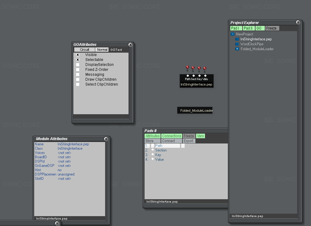

IniIntInterface / IniStringInterface can do what you ask

You can load them in the SDK via ModuleLoader.mdl
...From there you can make them circuit or surface components by adding GOs and attributes in the GOs window.
Unfortunately there isn't any .nfo files for these scripts so the functionality is limited to reading strings and integers upon module load and then prompting reading and writing via right-click.

I could load them and assigned GOs and attributes, but when I try to load it, I'm getting 'nil references'. Right click doesn't offer anything useful...

You need to take them out of the ModuleLoader - After loading one of the scripts fold the ModuleLoader. In the Project Explorer if you now look into the folded ModuleLoader you'll see the script. If you right-click on it you'll get read & write options.
If you assign GOs and attributes to it and drag it out of the ModuleLoader into your circuit parent or a surface panel, you'll then be able to right-click the GO for read / write.

That doesn't seem to work. When I drag and drop the pep file to the moduleloader, I see the wait-cursor and then nothing. I.e. the moduleloader is empty as before. I'm using version 3.0 (prelease) according to 'about'.

Enter the filename (including extension) of the pep script into the modules array of the ModuleLoader ...It's best in this instance to have the array size set to 1. Set 'load' to 0 in the ModuleLoader Pad List. This will load the module and if you re-select the ModuleLoader the Pad List will update to show the additional pads of the loaded module.

OK, I was able to enter the filename into the array and got the pep loaded. After that, I could drag out the interface (in Project Explorer) and add some GO (like frame, text) to it. But I can see the module in the circuit design only after clicking 'create circuit representation'. I also can see 'read' and 'write' menu options, but they don't do anything.As it turns out, the pep file is still within the loader, even the project explorer says otherwise. Question now: how can I separate module loader and pep with mouse?

After dragging IniStringInterface.pep out of the ModuleLoader rename it to IniStringInterface and save it as a .mdl.
You can now load this module and set the path field for the location of your text file.
Check out the cset.ini in notepad to see the format of Section and Key entries or simply enter them in the PadList, set the path and then choose write to update the text file with the correct formatting.
...Value is the string which will show for the key.

OK, thanks a lot. That works so far. I.e. I can create an interface module for each partial, use the same path, but different keys and get my values for each envelope curve. Nice.

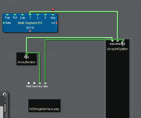

Netx question: how can I connect the value with the EG? Does is EG (1 for each partial) need a new new pad to connect to the value? Does such EG exist or do I need to create my own EG? I would like to use the Multi Segment EG, which has T L S entries, but I can't connect them to the Interface.

I'm a little step farther now: I can read/write array elements from/to file, but I haven't find a way to iterate the index in the ArrayIterator. I can do this manually and get the actual data, but I want to use something, which does this for each index (incl. read/write). Any ideas, how to accomplish that?
Or is there a function, which converts arrays to string (CSV) and vice versa?
