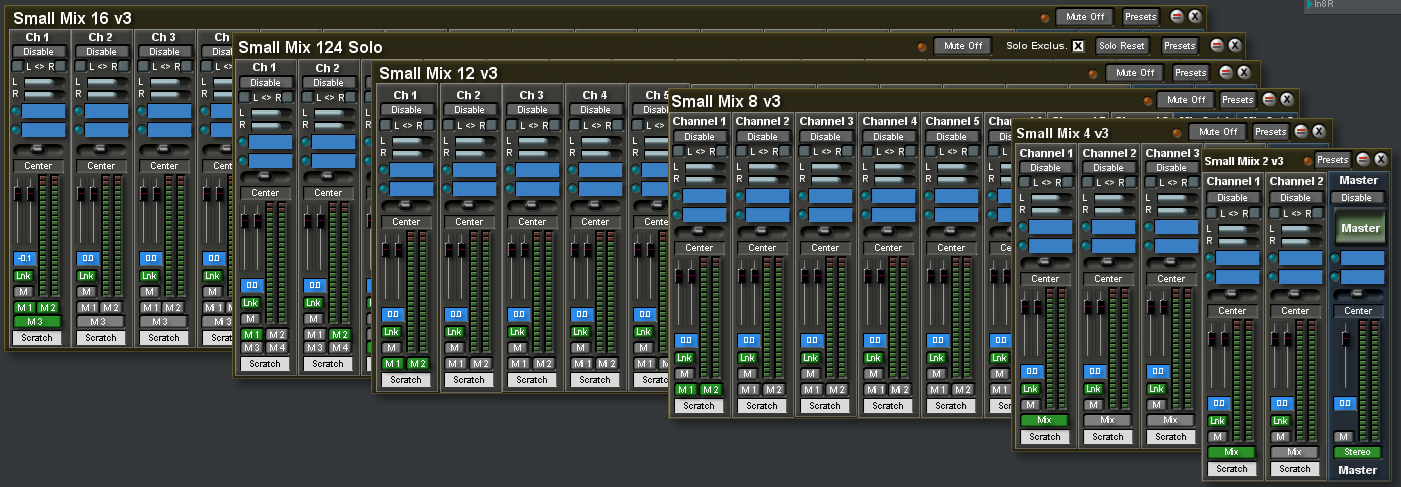

Hi There,
Updated (version 3) Small Mixer family.
Updates:
- Removed Drawers (Shublades) Open Drawers were not always displaying properly - now all controls are on the front panel,
- Optimised Range Text fields to better approximate actual dB levels, and
- Some minor optimisation of the panel.
Please note:
- Setting two separate Midi CC's to fader stereo pairs breaks the stereo linking and it appears that the only way to recover is by reloading the project or by deleting the mixer and re-inserting another instance in the project. Setting a MIdi CC to one fader (left or right) works as expected and is the recommended way to cc control linked stereo pairs.

A big thank you to Bud Weiser for assisting me with the testing of these mixers.
