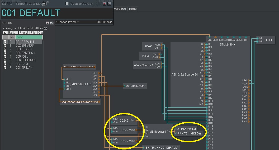

I use Scope XITE-1 live and send MIDI out of the XITE-1 into an HX-3 Organ Module and a Novation Peak synth.
Really good MIDI stability. Instead of direct from my controller I use Scope MIDI Devices to change drawbars of a virtual Hammond B3, a trick I can’t do from my controller or the PC.
So if you like the timing you’ll love the MIDI devices made by 3rd party developers here.
These are custom, not stock. Very useful platform.

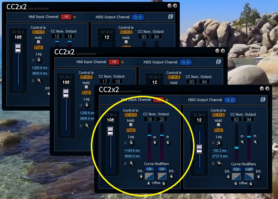

Here's the exact device I use.
It allows Curve modifiers that set exact placement/amount, and the lag processor allows rate of assigment or speed of it's destinations/targets.
This is for drawbars on a Hammond B3 module.
Instead of using hands to swell/collapse the drawbars, I use a single FC7 Expression pedal to send 6 different CC's.
Each drawbar can be set exactly as needed.
I dont need to ride the pedal with my foot.
I push forward and backward, the device does the rest.
[/attachment]
[/attachment]
