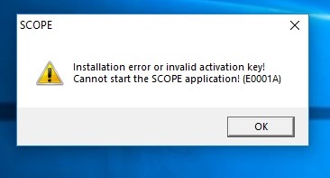

But now Scope imports the keyfile successfully too, but stops dead in its tracks because of an installation error or invalid activation key message.
Where should I place my keyfile?
It goes to App/Bin, but doesn't seem to like that.
So I copy my recent keyfile to Projects Folder, no Bueno....

Re: Bummer
Posted: Tue Aug 07, 2018 7:12 am
by dawman
Finally figured out how to take a snapshot.

The key file should be in the bin folder and Scope run as admin.
I have V7 PCI with Windows 10 and have no issues on that regard.

Yep tried that folder since it was default. Tried desktop, tried placement in projects folder, not sure that the importing of keyfile is the issue.

Odd though because it shows the import was a success.
It’s followed by the installation error message, then goes blank.
So we have connections, and imports workings, it’s the validation or installation.

do NOT disable driver signing. the v7 driver is signed!
the v7 key is just a key. your v5 keyfile is for your additional keys, which don't need to be remade.
copy the v7 key from the email and paste it into the registration window.

ok, but i think his problem is that he isn't using the v7 key. he's using his keyfile, which doesn't have the new v7 key. whether driver signing is off or on, the problem isn't related. :)

GaryB was right, I forgot to use the Activation Key.
