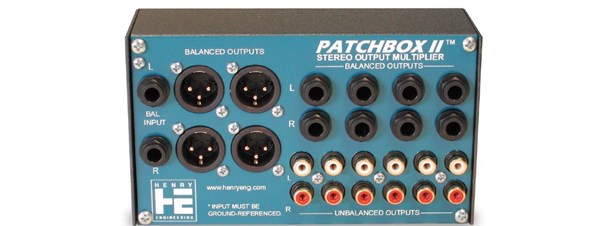

I also use Radial Space Heaters, DIs and a Henry Engineering Patchbox II which is a high quality multiplier.
