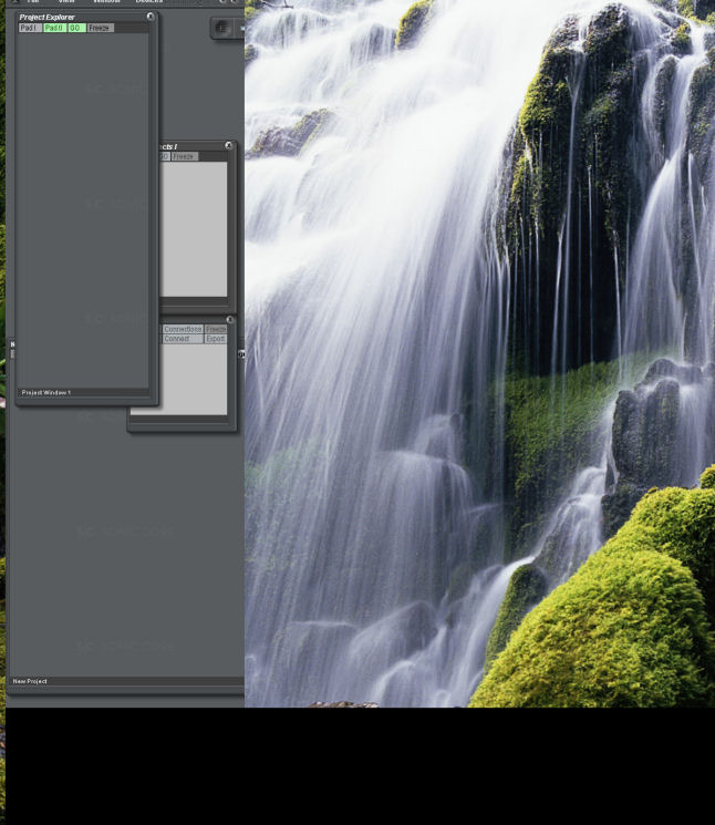

How can I can change the window size of the SDK, when I'm on a dual monitor system? The supposed clicking in the settings window didn't help at all. AFter installation it was just fine, but somehow, the size was changed.

As I said, this doesn't work anymore. Wharever I do in the settings window, there is no reaction. And yes, I'm in the bcmodular forum, but it seems quite slow these days...

After closing the SDK, the line I've changed (ScreenPositionLeft=0) was overwritten again with the wrong value (ScreenPositionLeft=2560). This is a minor annoyance, was worth noting for a future fix.
