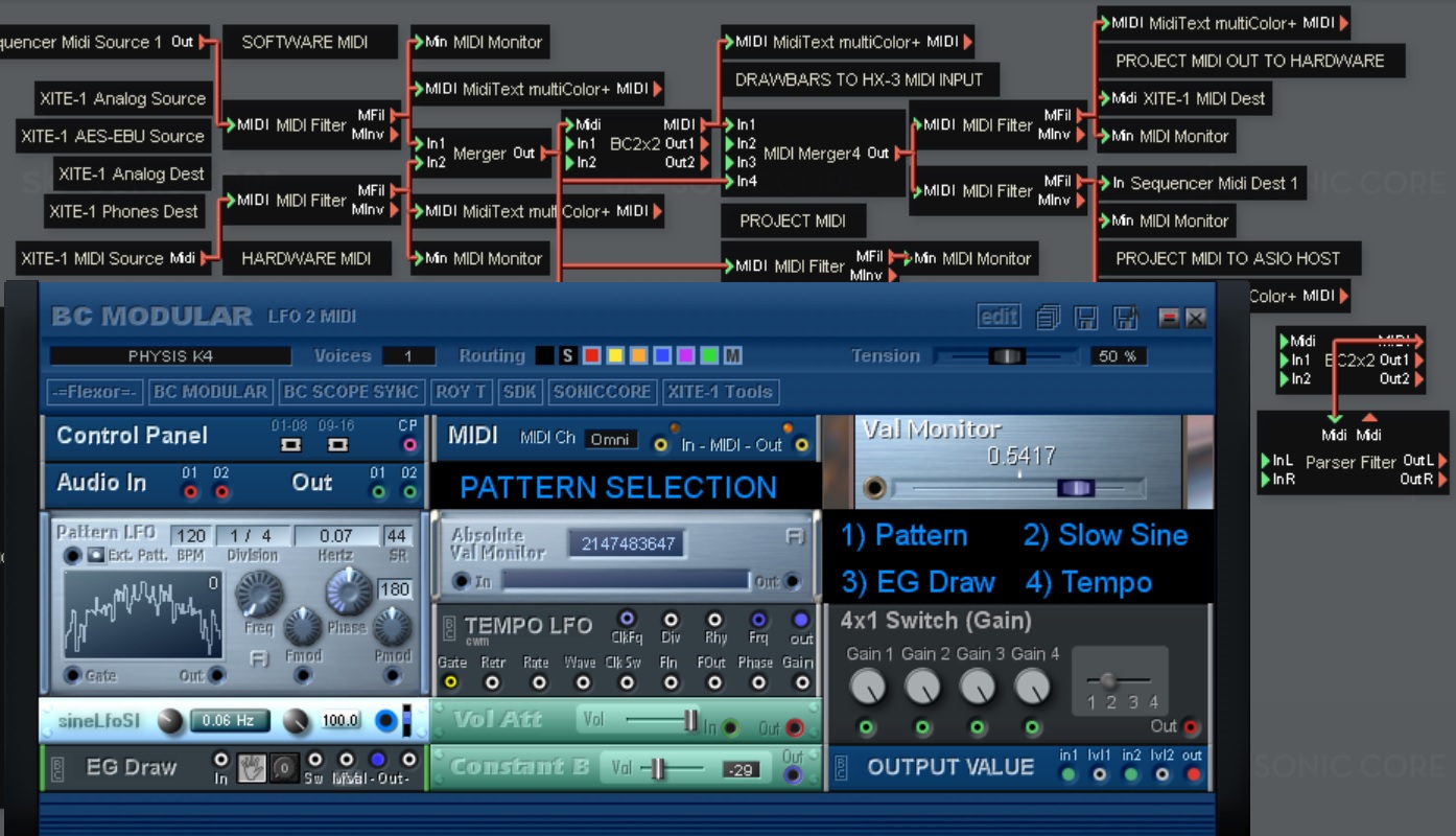

I like Ocean Swift's Filter so much I had to dig up at0m's old LFO 2 MIDI and modify it.
Parser is the best Filter we have for my tastes at least.
No audio dips or artifacts when maximum resonance is used.
So this Modulator is for creating laser like Zapps that resolve back into the 2nd LFO on
Parser sweeping or pulsating. That requires RoyT's Free Env. made for BC Modular.
I can trigger the Envelope from my controller using Buttons or Switches, even notes.
Aderns Pattern LFO with the waveform selector does really radical modulations.
Over 100 to choose from.
RoyT's super slow Sine Wave and then a Tempo driven LFO round out the 3rd and 4th
Modulation Source.
Parser Modulator.zip
(1.11 MiB) Downloaded 609 times

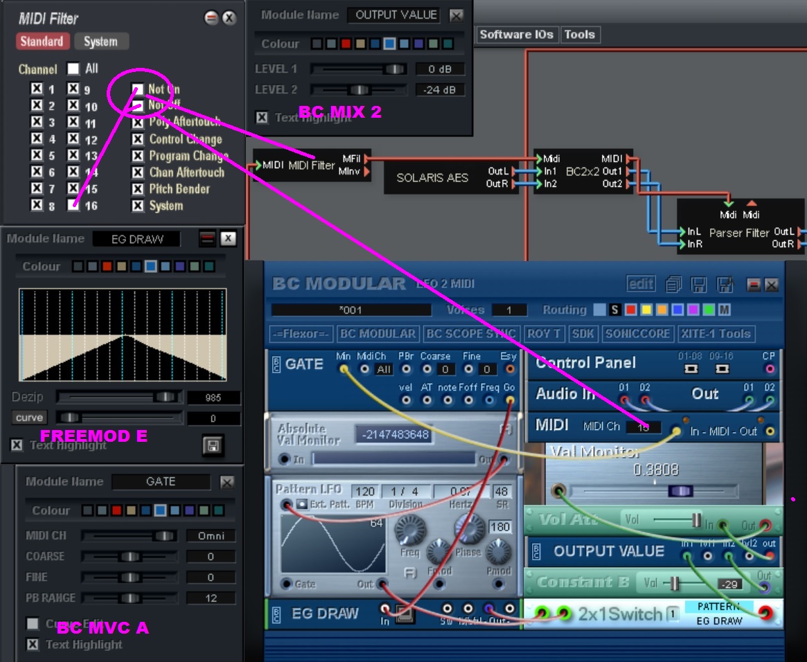

Here's an easy version I'll be using tonight.
I marked the names of the Modules used so disregard what I label them as.
Here's the purpose of the Modular Patch.
To give Parser Filter extra Modulation sources other than the 2 x stock LFOs.
Flexor III Pattern LFO generates LFOs not found elsewhere. So it can do real slow Sine Sweeps or it's own Patterns 0-128.
FreeMod E is what I labelled as EG Draw.
It's purpose is to be attached to a Zone on a controller, or a Pad/Button sending out note on/off messages.
I can trigger my own strikes/Zapps or rhythms by playing notes while holding a Pad on Solaris.
Ideally Cut knob on Parser Filter 1 gets the CC# assignment from Modular Patch, which is sent by the fader on Val module by at0m. Filter 1 on Parser has it's LFO disabled.
Parser Filter 2 can use a slow sweeping Sine Wave for the super slow sweeping sound.
While Filter 2 is slow sweeping a String Pad I am holding down (3-4 notes) on Solaris.
I am tapping the Button on notes on a Zone triggering the FreeMod E.
This way I can zapp the shit out of a chord or add a rhythm during a part as the Pad still maintains that slow sweeping filter sound from holding Solaris keys down.
Solaris as the jpeg shows, sends or receives no MIDI.
Hope this helps folks understand the unorthodox need, but I can't get anything in Native like this so I gots to make my own.
