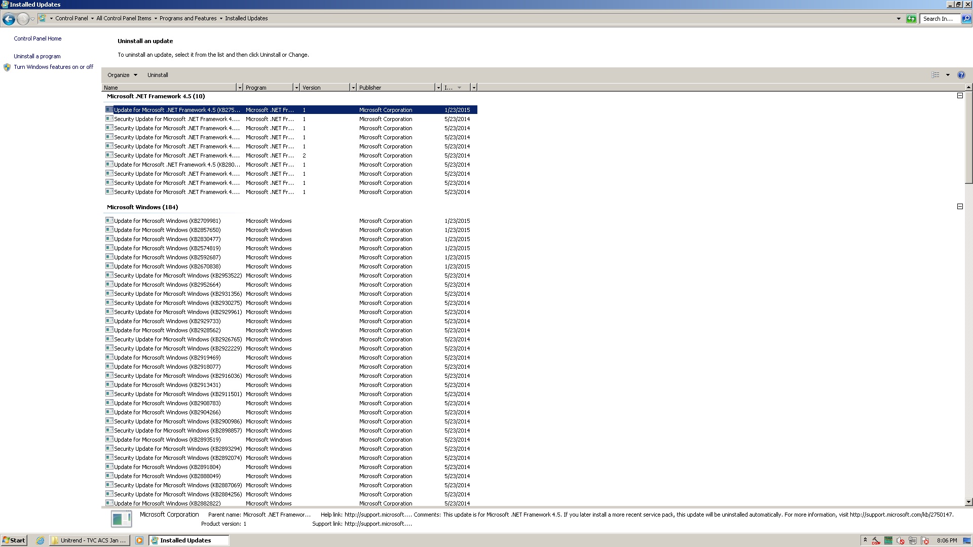

nothing happen. then i install all win updates. but nothing happen. detail problem is.. it look the video is moving from where it start! and flicking 1 frame when play/stop..
here is my win update list:
http://www.windows7codecs.com/
version 4.1.0
- update win7 ult 64bit.jpg (450.67 KiB) Viewed 3103 times
