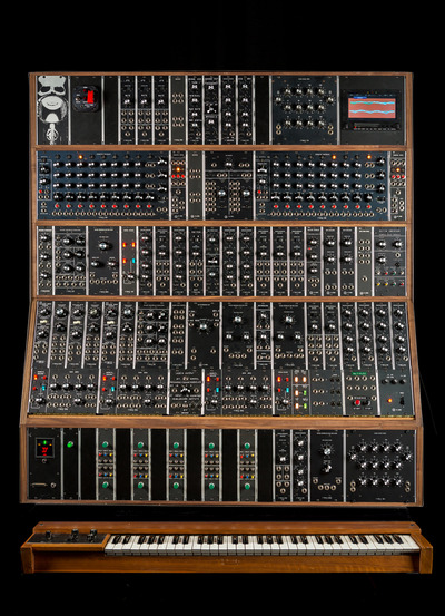

The Emerson Moog Modular (released at MoogFest earlier this year) :
Would this be possible (even if too hard) to do in M4? Development of the custom handcrafted unit took three years with designers using the original documentation as well as circuit board and art files for nearly every original Moog module.
I dont think anyone will do it, Im just interested on opinions on whether M4 would have all the required circuits and enough power on a single XITE-1.

Hard to tell from that pic.dante wrote:The Emerson Moog Modular (released at MoogFest earlier this year) :
Did you investigate into all the modules used in Emerson´s modular synth ?
We´d need a list, than compare what´s available in Modular I / II / III / IV / CWM and BCM up to now.
I expect possibilities in SCOPE are far superior meanwhile and compared to the hardware MOOG modular synth.
The sound of MOOG is all about the ladder filter and envelope generator speed.
IIRC, someone (fra77x or Sharc ?) offered "vintage ADSR" for SCOPE modular some time ago.
Array of Stepsequencers won´t work in 64Bit SCOPE for the time being I fear.

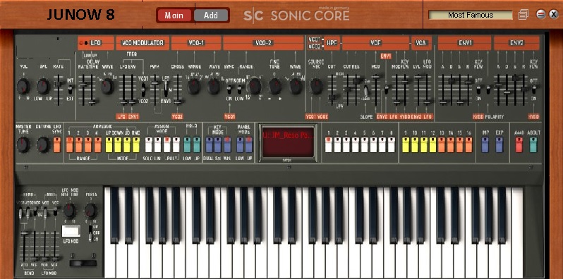

That´s not a JUNOW 8 ...dante wrote:Failing that, how about a new classic synth emulation for Scope 6 ?
It´s a YOU PEE (EIGHT) ...

I'd take the JP8 any day. With the Emerson we sometimes found it hard to get the same sound twice for the same patch.
Re: Can we have a recreation of this in M4 ?
most of the scope modular series of modules are compatible there is a ladder filter
missing from scope but i have made it is the fixed filter bank
and most things can be made with bcmodular and the circuit module shells
in fact most modular modules from all designers have extra level circuit modules
they use summers which take several inputs and summ then to one level
then there are attenuators to change the level going into the module
then there are output modules with attenuators for output levels
some have inbuilt lfo and also cv mixers
we have all these circuit level modules and can create similar modules in the clm shells
thats how i did the polymoog resonator and the sem filter and the fixed filter bank and the 4/8 equinox phaser

Good stuff, so M4 can cover most or all of the ground covered by the $90,000 Moog Modular.

Hans Zimmer has a wall of Moog Modular in his studio and he said once,- SCOPE Modular beats all exisiting hardware modular synths out there.dante wrote:Good stuff, so M4 can cover most or all of the ground covered by the $90,000 Moog Modular.
That might be somewhat overrated because real analogue always sounds different compared to emulations and it´s a matter of taste too, but functionality wise, a great sounding total recall modular synth where you can easy swap modules, is a big advantage over the old patchchord beast w/ their fixed set of hardware modules,- and don´t forget how bulky they were.

it can do stuff the moog modular can only dream of
multisample osc
digital osc wavetable osc
waldorf wavetable scanning
moog only had 2 filters hipass ladder and lowpass ladder
then it had resonators
you have multi filters and can create any type filter you want by combining fllters
i have just made a extended version of the serge resonant eq
which has 10 fixed bands of bandpass filters that are 7th of octave frequency settings rather than the 3rd octave setting which give it notches
in places that normal eq dont have that are musical
it has 3 out puts 2 combs and all bands the resonant feature is also very interesting as its not done the same as usual as a negitive feedback added to the incoming signal
but each band has a pot and the wiper goes to the filter input and each end of the pot one goes to the input and the other goes side is from the summer before the final vca
so it mixes the input and out put and when you have it fully on resonant it does not self oscillate but has a nice resonant quality as its just the feed back input and not both the input and output
on my version though i have it with lowpass/bandpass/hipass/variable notch so my version has 12 audio outputs
you also have fm osc and additive osc
and drum osc
and by using several modules you can create quadrature osc these are great for phasers in a dual stereo as you can have several banks of series allpass filters
and for the right side you can use the 180 degrees phase while the 0 degree phase on the left channel
and by have a quadrature osc you get 8 lfo outputs at different phases and there 180 degree opposite phase outputs
this creates a lot of notch bands by having 4 sets of allpass 4 stage phasers and each has its own lfo modulator and there outputs are summed
and the opposite channel has the same but uses the 180 degree phases opposite lfo outputs you can get some great phaser effects
the same thing can also be created for pitch and frequency shifters
any modular module you can think of in hardware can be visualized with bc modular and clm modules
as all the building blocks are there that are available for hardware
and for visual if you want it to look the same the new scopesync and its xml gui implementation you can create the modules in the modular then skin a gui so it looks how you want it to look and control the modular modules

and if you look at that moog modular it has multiples of the same modules so it has banks of oscillators
banks of filters banks of lfo banks of envelope generators banks of cv mod circuits it has 2 fixed filter banks and 2 sequencer modules banks of vca and a couple of mixer modules with panning circuits
there are not that many single modules there at all
with scope 2/3/4 modular there are 300+ modules
then theirs the flexor 1/2/3 which has lots of modules
then theirs the spacef modular modules
the john bowen rd modules
bc modular modules 300+
then there are the sal modules
and roy thinnes modules
we have a massive amount of modules to choose from which would cost £1000000 if we brought the hardware equivelents
and by using the clm shell and combining modules to create complex modules you have even more scope for new modules
Hello all
Sorry but what is Junow? Is existing? a new plug?
Thanks
Thanks
no its just a picture that dante did for a wish list
a jx8p voice would be easier than the jupiter 8
as the juno osc is available and you just use 2 the jx8p also has an extra envelope than the jx3p but looses the sequencer of the jx3p
i have a modular module of the dual chorus as used in the juno
