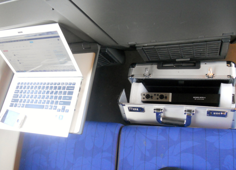

Holger came with this great tip for the Xite-1 on the road:
Allumax pilotenkoffer. E90,-.
You can take this into the airplane.
Here, the Xite-1 likes the train too:
Xite-1 on the road

Xite-1 on the road
- DSCN4899.JPG (137.13 KiB) Viewed 3721 times
