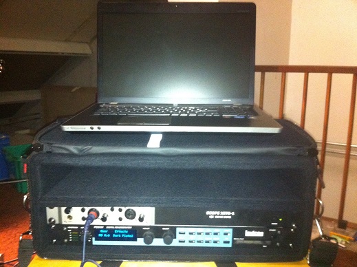

by RP_001
I have this 2U gator bag which hosts the xite-1 and pcm91. I noticed xite can get very hot when using a couple of hours, but I havent had any problems containing communication errors etc. So for now, it works just fine, but I want to buy a SBK 4U so I can put in an 19" cooler (and a Clavia G2 engine eventually :)). This might also be a better option for quickly changing cables from my mobile setup to my "normal" pc setup in my studio upstairs. At this moment I have little space in the bag for this, so changing cables is a bit annoying.
