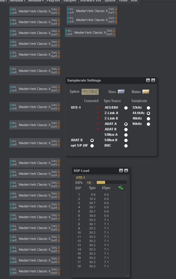

I also used this trick with renumbering the boards to make my 14DSP-board to be the master.
Nevertheless, the performance of Xite1 is a big step forward compared to pci.
As I'm still on pci, but I also own a Xite1, I just did the famous Masterverb-test on the same PC-Hardware ( Asus P7P55D ).
Result: Xite1 can handle 23 Masterverbs.
As my setup didn't reach the limits of pci yet, my migration towards Xite1 is a process of years
- Clipboard01.jpg (98.99 KiB) Viewed 8479 times
