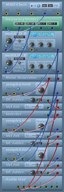

I put together this toggling sample+hold patch based on a diagram I got from the Doepfer site. The three audio outs are going to the three oscillators of my MFB Kraftzwerg via Expert Sleepers ES-3. My question is, how can I make this patch more efficient with less modules by using gates instead of triggers? I tried swapping the frequency divider for a clock divider and sending the gate signals into the S&H modules, but it doesn't work. Only the trigger input works. I turned off the button on the S&H modules (although the manual doesn't even mention what this button does) and still no difference. How can I modify this patch so that I can remove the LFOs? If you're wondering, I'm using the Vol Att and DC Adder modules to focus the frequencies to a specific area so I'm not sending completely random signals between 0 and 10 volts which doesn't sound too good.
Here's the patch in action:

- ES-3 Toggling S&H with Bass.JPG (49.84 KiB) Viewed 4170 times

Re: Help with gates
Getting back to my original question... How can I simplify this patch?
