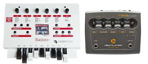

Ferrofish B4000+ I suspect to use some SonicCore technology with the addition of a Neo Instruments Ventilator I suspect to use some InDSP/Use Audio technology ...

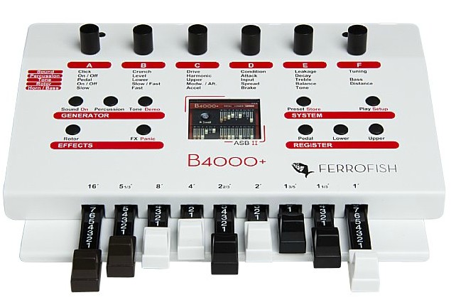

I hope you like our new B4000+...the old B4000 needed some facelift, now it looks more modern and attractive I think.
As you surely suspect, the B4000+ is based and developed on Scope/B2003, its really still the best platform to develop audio hardware!
Concerning the DSP code, compared to the old B4000 we have a new rotor code now, also added a nice reverb, and did some smaller enhancements and bugfixes.
But most work was put in the user interface, as you see the B4000+ has a TFT display, and also a fast ARM processor is doing all the controller stuff.

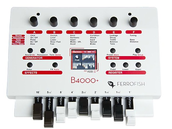

It's really fun now to play with the parameters, although the old B4000 had some more knobs, you can now edit >all< parameters on the B4000, so no need for PC to fiddle around there any more. Also we replaced the encoders now by six "endless" potentiometers with metal shaft and cap. They have the same resolution and feeling like potentiometers, but can be turned endless (dont have an absolute position). Below some TFT screens of the B4000+.
We're still working on our website for more information, but feel free to ask here or on my email if you have questions for the B4000+!
Greets - Juergen

Just a few question regarding the user interface which looks quite straightforward:
- how do you select the parameter row ? I suspect selecting it also select the correct screen but I do not see how to do it.
- what are endless potis, encoders without detent or ? are they also push type to allow them to be used for switch parameter on/off ,
- what type of ARM (I guess the same range as for your beautifull A16 Mk II), what type of DSP (same as in the Xite) ?
- I guess from the screenshot that you add also a compressor to the effect range ... is it based on a known scope device ?
Nice work anyway, the B4000+ is the first scope based device available since the Noah which allows complete standalone use but with a much better thought user interface. Any other ASB II under developpement ?

Concerning your questions:
Right, you select the screen using the keys, then you can adjust up to six parameters using the dials. Some keys have more pages (like rotor->horn->bass), you press the key repeatly to toggle between the screens. Also, some few used functions you can access by pressing the key long (written in red on the panel).
Its very intuitive and easier as it sounds here :-)
No, these are real potentiometers, to be precise: two pots in one case, one is mounted with 90 degrees angle so when reading both pot positions we get the position of the shaft. It has a much smoother feeling and higher resolution as an encoder.
Its a Cortex M3 ARM, the controller software is written completely in C++. We used a different Sharc DSP, but from the same series of DSP's. It's the ADSP-21262.
Yes, its a Scope compressor, only few modifications for easier use.
-Juergen

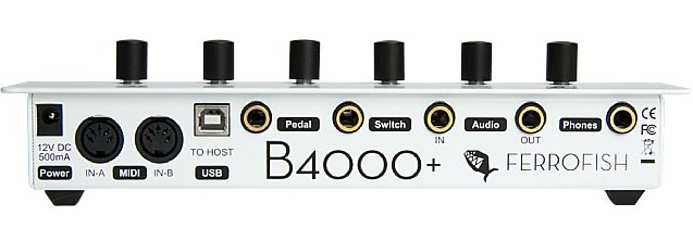

bit less than 2kg, and 24cm x20cm x 5cm

The Ventilator is also a Sharc DSP box, but made in Reaktor from what the developer told me.
The fact both units use DSP means realtim at it's finest...
Congrats.
