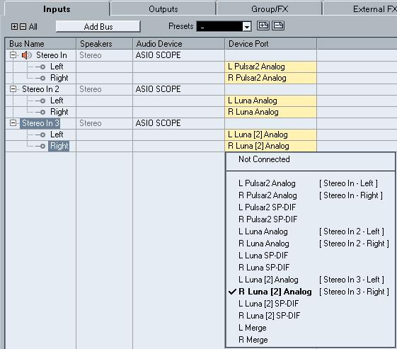

SOLVED! Help! Cubase 5.5.1 and scope 4 asio problem
Posted: Tue Sep 07, 2010 8:28 am
by djstudio
hi, i have solved :-)
I remember once I had the same problem that i had solved as in image:

Re: Help! Cubase 5.5.1 and scope 4 asio problem
Posted: Thu Sep 09, 2010 11:52 pm
by djstudio
The problem is back
updated to Scope 5 :lol: all problem solved
