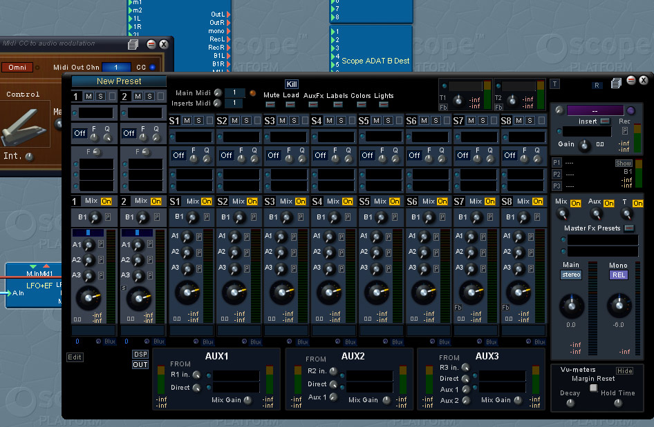

I have the best luck when I use a mixer that I can stick on DSP 7 and pack it until it hits around 6500. Then Assign it.
STM1632-X is a good mixer, as well as Micro-X & Dynamic-X too.
My beef is they don't have true stereo AUX channels. I thought I could use these and then stick the Stereo Expander in the Master Effects slot as a work around, but it just isn't as good.
Since the latest upgrade I have been able to see lower numbers in the DSP Meters' left column so I tried a few SpaceF mixers. They will load easily but once I start packing on effects they spill over to other DSP chips which in turn causes lower polyphony on un-optimized synths.
The good news is that SpaceF's older MixSat C has the same stereo AUX's I crave and uses DSP resources like an optimized STM mixer would.
So I decided to pack it w/ effects and see how much I could get.
I loaded all of the important ones, and thankfully my synths all have Flanger/Chorus effects, so I decided to use the synths modulation effects instead.
I have my true stereo AUX's now, and I am a happy camper because I have mixed like this forever and do not wish to change.
But SpaceF's MixSat is a great 6 x Mono, 8 x Stereo, Dual AUX mixer, and I can still stick a couple of FAT-S plugs in it for the FB5/V82 sound.
All of the stock synths and Modular can also be used like this too.
B2003 only uses half of a chip. Which actually is equal to 3 of the old chips. I needed 3 DSP's for each instance of B2003 before.
This means with the latest optimization we seem to have 5-6 times the power.
If we ever get the 10 x power that we heard about I will be seriously impressed.
As it stands right now, I have plenty of power, but once we get everything optimized I am sure there will be few barriers.

I can actually use this. I can load all of the AUX's and Master Effects, and 4 x SC-Chorus, and 3 x SC-EQ-S's.
4 x Mono channels get 2 x XOR's, stereo 1 & 2 get the B2003 & Prowave, the BUS gets my Analog SE-1, then 8 x channels ( stereo ) fro the Kontakt/GVI instruments.
AUX delay, SC Ambience and DAS 224 in the AUX's.
I use to get 3600-4200 in the SYnc column when loading FP104 & FP106, so this is perfect for single chip assignment...............ANkyu..
Mixing Saxes & Brass in Bidule from 6 x stereo channels down to 2 x stereo channels, and 4 x stereo String channels down to 2 x stereo works just as well.
Damn I sure love my rig...

I have the new version which is really sweet.
The dual slotted AUX channels are where it's at for me.
Stack an EQ on the Reverb for precision control.
Stack a Chorus on the Delay for those sweet tails.
Yeah this is definately the Mixer for me.
I wish they'd send Mehdi the SDK so we can wage war again.....
Well what's the use of talkin' 'bout how good it is if you don't post a snippett, so here's the reverb w/ the EQ.

Here's another great mixer for single chip assigning.
I like running the Warp69r's and PT verbs externally. That way I can pack the mixers inserts with plugs.
The usual excessive MIDI controls on dual channels, the 3 x Stereo AUX's and A-H Modulator Channels.
- spacef
- Posts: 3417
- Joined: Sun Jun 17, 2001 4:00 pm
Re: Single Chip Assignments
what's that crappy graphics you got on the mixer jimmy
have the latest version from user area ?
EDIT: ah, yes it is my fault, did not remove the litten graphix....
well, might correct this in the future .... for the moment, may be better not to use the lights (unless you don't care which is fine with me, but this pic was like uuuh.. shocking.....now i understand.. all apologies for illumination lovers.... )
have fun with the freeby....
(for others, visitors etc, don't look for that device.. it is an optical illusion, it doesn't exist...)
