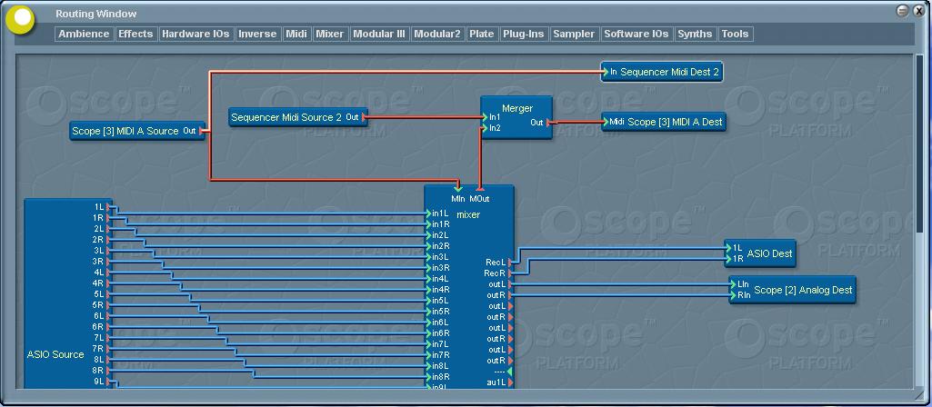

I modified the Reaper MCU plugin for it to "ignore" and "not send" some information from/to the MCU, so that the MCU can be "shared" between a device in scope (Wolf's mixer in my case) and Reaper.
Basically it leaves the 8 channel strips and the master strip for the mixer, and consumes / sends feedack for the display and the global section (markers, transport, jog wheel, automation modes, zoom).
In order to use it, the SCOPE midi source must be sent both, to the mixer midi in and the seq midi dest, and the seq midi source and the mixer midi out must be merged into the SCOPE midi dest:
There are also a couple of reassignments to do in the mixer as of the defaults(in the master assignment the aux 1-4 should be set to 42-45 in order to leave the F1-F8 buttons for the markers in Reaper)
