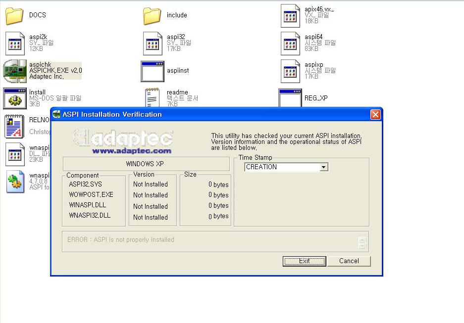

As shown on Creamware site, tried to install ASPI before install Scope 4.0 S/W. But with the following message, installation has stopped.
Please take a look attached jpg file.
prey not give up installation
Thank you all.
ASPI install on Window XP

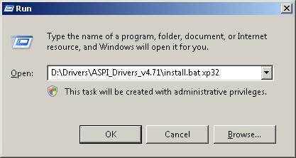

I think that its your mistake...
You should install ASPI using the "Run" command from start menu.
1. Click "Start" and select "Run".
2. Click "Browse" button and locate "install.bat" file (inside ASPI installation folder).
3. Now in the "Run" field you should see address of your "install.bat" file. Move the text cursor to end of address and enter " xp32" (with space before xp32). And click OK. After this, restart your machine.
See image...
See image...
