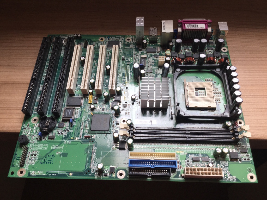

Yesterday this thing arrived:
Bad luck: my supposedly socket 478 CPU wasn‘t... :-? which turned out as an advantage, though.
To find a proper match I had to read a lot about those P4s, lots of answers on questions I never dared to ask. :D
Anyway... I ordered 2 mobile Pentium 4-M, 1 spare if manipulations for VCore fail or if I fry one of them.
Thanks again to @PlanetZaxxon because he triggered the action - waiting patiently now another couple of days...
The board is a DFI-ITOX G4V620-U, Intel 845 chipset with internal graphic. Iirc I had an 845 ages ago which performed well with 3 Pulsar Ones.

The board is supposed to host a HardSid Quattro ISA card and since there‘s another ISA I‘ll add a Yamaha SW60XG to run XG-Gold... and of course 3 Scope cards to receive those 6 analog channels from the SID and XG.
(leaving the shared 3rd ISA and 4th PCI free)
I expect the mobile 2Ghz CPU to drop to 1Ghz when plugged into the desktop unmodified, and hope this drop will reduce power consumption and heat. Cycle loss isn‘t a dealbreaker in this case with no DAW running on the machine.
But I‘ve no idea if fiction will meet reality... (it‘s a nonsense project anyway, mainly to prove it can be done) :D

Things just went too well... all arrived in time and assembly was easy. Powered up , memory 1G and clock 2Ghz (20x100) were identified, drives showed up. Watching temperature in bios for half an hour showed a stable 37-40 Celsius, so the cooler seems to fit.
But whatever I try to boot shuts off the machine silently, no beeps or errors, just switches off :(
Runtime until death varies from 2 seconds to 2 minutes (the latter with a Win-7 installation CD).
Never experienced a similiar scenario before.
ps: never mind - it‘s probably the tension of cooler mount, just installed Win2k ... but with the PC flat on the floor so the cooler is pointing downwards exactly vertical. In tower orientation the weight of the cooler (Scythe Katana) may make one side come off.
The mobile CPU lacks the heat spreader and so is slightly more slim than a regular one.

I‘m rather certain that overheating caused the shutdowns as the bios temperature is down to 34 Celsius when the cooler‘s weight is pointing exactly down.I‘ll probably replace it anyway as it blows against the airstream of the psu.
The Win2K install was pure chance because it happened to be the 1st CD I grabbed just to change conditions, but it‘s been working without a glitch (while searching old CDs for the graphic and chipset drivers) for quite some time now.
I have a couple of aluminium foils (parts of an old camera :D) in different thickness to cut shims from...

Scope and SAW Studio are installed and the onboard graphic delivers 1920x1200 dots in acceptable quality.
I could transplant the heatspreader from a dead P4 to improve placement of the Katana-2, but the system works well in it’s current horizontal position.

Digging around for info on how to space the screws to get the right downward pressure and height, shows that our global brain needs better search tools once something is out of cultural fashion. Silentpcreview.com is the only content I'm finding that references anything remotely useful, and the most relevant result is as follows:
Reference the part that starts with the bold heading AOpen Socket 478 HS Options and you can see both the downward force compared for P4-M & P4 desktop cpu's, as well as his measurements of the difference in height.
This board uses the "Traditional" flex retention bracket style, and should actually work with most coolers that fit that bracket as the tension simply pushes down on the heatsink, and based on the previous article the lesser pressure might actually work out based on this difference in height.
Contrast that with the screw-into-backplate type cooling with this motherboard, and you'll see why I figured you might be able to adjust the height slightly with some washers on the rear-side (either between the rear-facing backplate and board, if the screws from the mounting mechanism go all the way through). Nonconductive (red) washers are probably best here, just in case they touch a nearby component.
Re: Definitive Scope PCI card host PC?
Posted: Sun May 16, 2021 6:54 am
by astroman
thanks, some interesting measures on that side... I usually rely on fingertip intuition only :D
Imho the main problem with clamp mounting is the difficulty to put it in place untilted (to avoid tension to the side of the die), so my vote would be the screws method, too.
But the compensation of distance (with clamps) is actually simple: just glue 4 small strips to the clamp holder.
I‘ll replace the Katana-2 anyway if the system gets back to tower positioning because the mechanic load would require some mounting support (as shown in the article) to reduce downward bent caused by weight.
It seems to be a very effective cooler, though, with it‘s polished copperplate/heat pipe.
I have some background in mechanical construction (lathe and milling) and most (budget) stock coolers are plain rubbish from that pov. It‘s all about contact of 2 surfaces that have to be as plain and even as possible.
For reference I often (ab)use a prism from a broken binocular. With fluid between metal and glass surfaces interference will tell a lot about surface match.

The SW60XG and XG-Gold were a piece of cake... immediate success, while the HardSid turned out to be a lemon. :-?
(I can only pray the 4 chips are still ok, there’s a repair trace on the card that I couldn‘t male sense of)
Will use a Teensy (Arduino) as test environment once it arrives.
(someone designed a minimal interface and a piece software to address the SID)
The motherboard is of course not the definitive Scope host, with just 7 reliable Masterverbs.
It was an interesting experience, though: in lack of vcore access in bios I bent one of the voltage selection pins and vcore dropped (as expected) from 1.66V to 1.2V, idle at 34 Celsius and fully engaged 38 (the idle temperature with 1.66V).
But it needs only minimal cpu fan rotation. Really cool... in the true sense of the word. :8
Atm the system is slaved to an Audient ID22’s Adat as clock source and a Luna as PCI master for low latency.
The Luna has it‘s own interupt, but when the „clock Pulsar One“ happened to share with the onboard graphics it was clicking galore.
I‘d rather guess a bad optical cable or some Adat trouble... so it‘s worth checking IRQs if the digital connection misbehaves.
