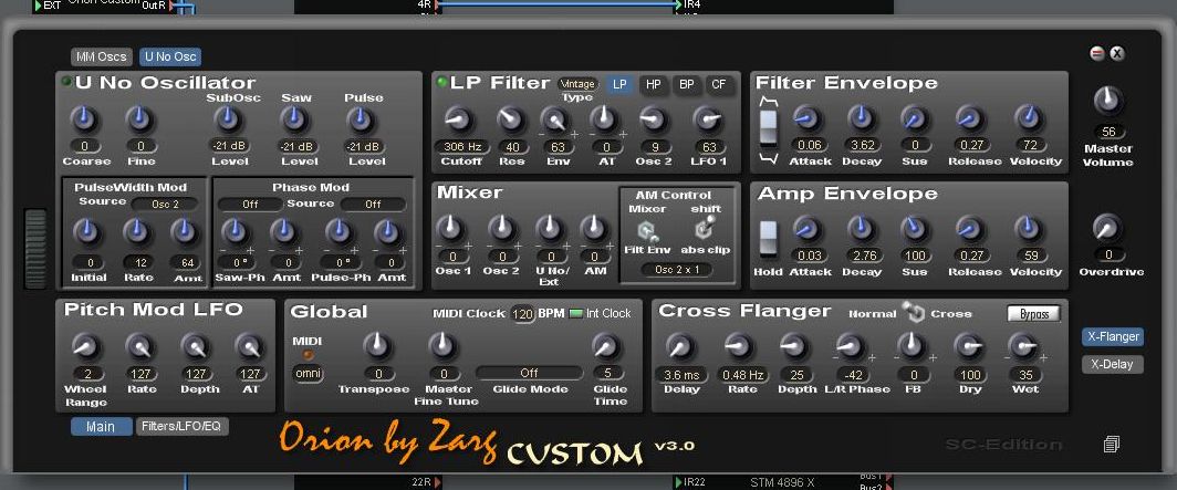

Here's my screenshot I just took a minute ago:
Orion crop.JPG (98.78 KiB) Viewed 6218 times

yes that's the one I have as well
