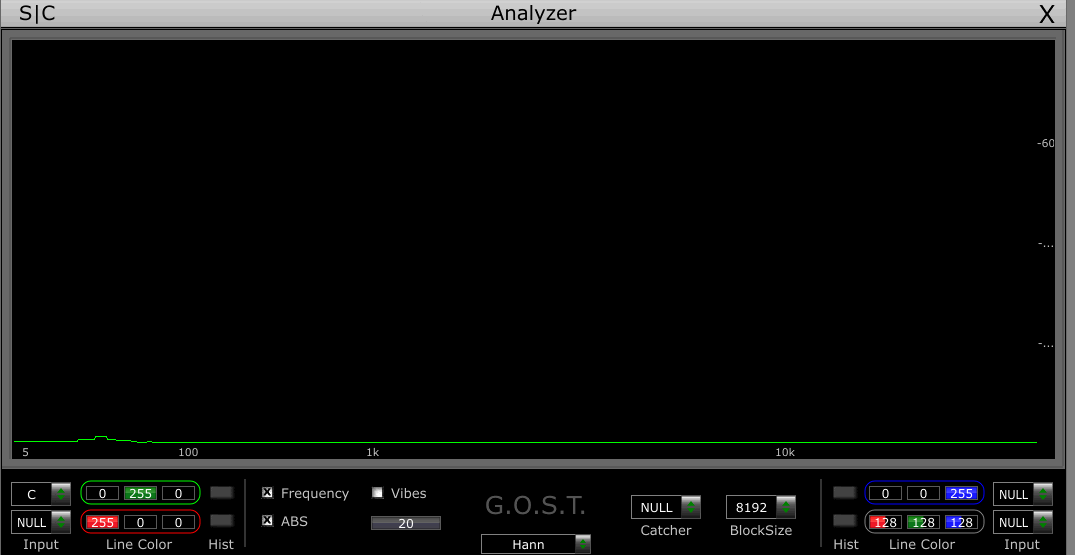

Wonder what white noise would look like? And shelved eq or band pass filtered white noise?
Should be flat across the spectrum..
See what Voxengo Span shows on an Asio feed. Its free..

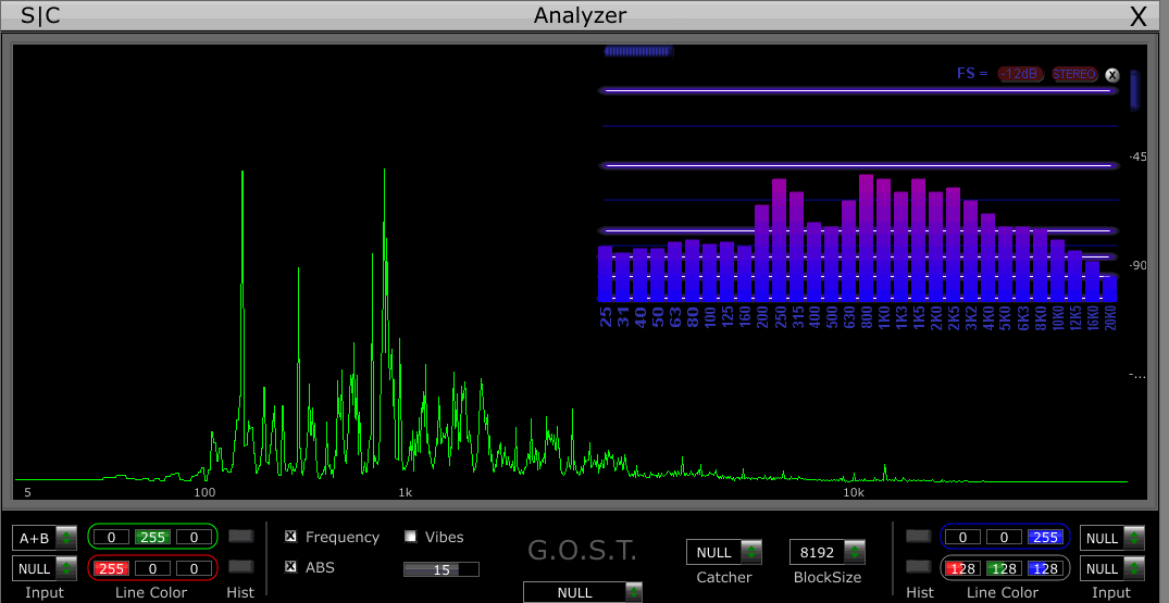

Heres a result from playing a piano sound from MIDI. First, a low 'C' ( 2 octaves below middle c) then a high C ( 3 octaves above middle C ). So 5 octaves apart.
So in the course of a norrmal rock mix, most of the activity takes place on the left hand side of the graph.
I'm assuming thats normal due to bass needing more energy at audible levels than higher frequencies ?

Re: New G.O.S.T Analyzer plugin
I don't have the plug in, but I see on Dante's screen shot, that the scale is not even. Harmony wise, the distance from 100 to 1K is the same as from 1K to 10K. So it is natural to have the bass area peak higher because it has more "notes per pixel". This is the usual thing with FFT analyzers b.t.w.
Ok, more even height wise but still all on left hand side. This would be to do with horizontal range rather than vertical scaling, so do we need user definable horizontal range ? EG 5 to 10K would use all the display on some of my mixes but still tapered high left down to low right.
At a Scale of '20', I put through a commercial remix of Bon Jovi 'Dead or Alive' and it went up to 15K, but again, as per your original observation, the bottom end was showing way higher on the graph tappering down to the right hand of the graph where it disappeared altogether at 15K.
I thought there was a problem with low frequencies being reported at higher values than high frequencies.
Frequency displays are typically logarithmic (in the x-axis as shown here), so this isn't unusual. When it comes to determining energy content, or looking at octave bands, this is actually really helpful and mimics how our ears hear. (Octaves double in frequency with each octave, so a linear sweep up a piano keybed is a logarithmic sweep in frequencies).

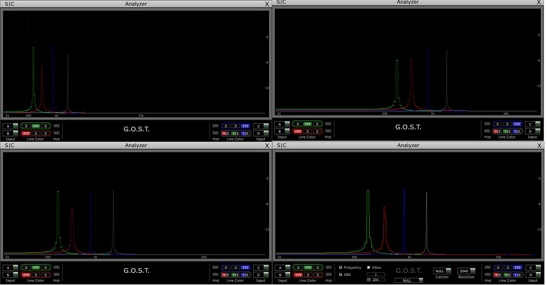

you are watching blocks of 8192 samples;
some high frequency does not go over this full time;
so they will not show full energy;
for higher frequency use a smaller blocksize;
check with a sinus at high frequency that stays on over the full periode of 8192 samples;
and catch it to have the same phase;
the x axis shows most possible measurementpoints by having a loglike scale in the fundamental range;
here you see 220 440 880 1760 Hz at different x axis stretch with a 2048 blocksize;
there is not much difference in all of the views with different stretch;
good vibes
thomas
