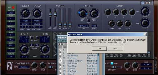

Re: Adern Announces Xor and Mojo, Two new plugins for the Scope
I set 4 voices of poly, then when changing presets I get the msg below, even though my DSP meter is fine. When going back to 2 voices, preset changes are smoother.
and if it lands on the 15 dsp card you get no errors?
hmm
im away from my DAW at the moment, but i also get communication errors at times. i can look deeper into it over the weekend, but to me it seems to happen when i spread the device across my 2 cards (Luna 2 and a 6dsp XTC). Fom my part i seem to remember that it helps to first fill up my luna with mixers etc, then load Xor.
On the other hand, if i skip the mixer i can fill all my 9 dsp with xor voices without trouble. the error occurs when changing presets, but not on every preset...
I also note that when trying to reallocate DSP resources, i dont just get the single "click" sound as usual, but more a "rain" of quick clicks, like if you are jerking a bad audio cable.
I can look deeper into this when im back home.
PS. I find it strange that isistoy are experiencing this with 4 voices on 2 15-dsp cards, as 4 voices takes almost exactly 4 DSP. BUT as a coincidence, most of my trouble happened at 4 voice poly as well, on the demo i made above i used 5 voices and had no trouble....
i will do some tests, and when i go to messe i will consult with holger maybe there is a way to solve this :>

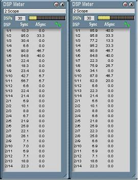

Thanks for sharing that experience.
I checked and everything is fine with 3 voices. Not tried with more than 4.
I'm not sure it is a pb with the plug itself and I can deal with it now without any other pbs, in reducing the voices (cool to keep the setup out of preset changes by the way: voices, tempo, unison, mod & pitch wheels)
The thing is that is mislead you & myself saying it's loaded in the gen 1 board: I guess not as my mainboard is a pro gen2. The second one is pro gen1 on which I load my mixer. So there is plenty of room for plugs on the main board and I guess it's the first to be filled with when launching new plugs.
So to say, I actually have these DSP charges before and after Xor is loaded (board1 : gen2 & board2 : gen1):
Edit: 3 voices
Edit: 3 voices
