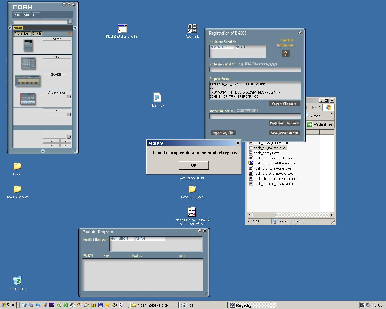

So,- when I enter a key,- p.ex. for Interpole (and because I have a individual key for Interpole",- I simply get copy protect violation error.
I don´t get when I load B-2003 and enter that key and save.
Just an example ...
AND,- up to now, I ´didn´t use .oxe-files at all.
Is there any correleation of using/not using .oxe-files and copy protect violation error messaages in NOAH EX display ?
What do I miss in regards of the installation of the devices,-p.ex. on computer in Remote editor software ?
Actually nothing installed in NOAH EX by the flash rpocess appears in the editor software.
I cannot load the devices in the editor even synchronization works automatic,- once I entered any key and saved, these appear in the Remote editor´s registry.
But also invalid ones !
And none of the device in NOAH hardware are activated then.
corrupt data in registry.JPG (116.34 KiB) Viewed 34586 times

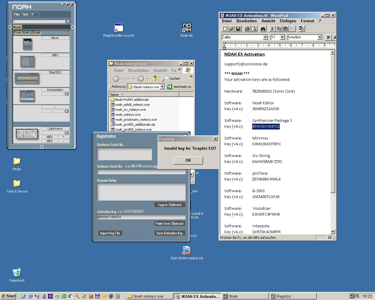

When I tried to enter the "Synthesizer Package 2" key to activate Lightwave,- I got the following message ...
a nitemare ...

There MUST be a way activating the devices in NOAH EX and Noah remote editor software,- no ?
@Gary:
Do you think the keyserver will be up again one day, so there´sa chance to get a fully working keyfile (.rgy) later ?

it is NOT a key problem.
there does seem to be a procedural problem, but i don't know what it is.
the registration window in the latest screenshot isn't a device window. there's no device name at the top. it must be the editor asking for a key, but i don't know. it's been years since i did this, like a lot of years. write me at support again and give the serial number again. i'll have him export a keyfile instead of as text, but there is no reason that the text wouldn't work. i've used text before.

garyb wrote: Tue Jul 27, 2021 6:57 pm the registration window in the latest screenshot isn't a device window. there's no device name at the top.
Well, after I pasted "Synthesizer package 2" key from clipboard into the activation window, at least Lightwave device appeared in the live-bar ...
But Noah´s display still said "copy protect violation error - please reboot".

garyb wrote: Tue Jul 27, 2021 6:57 pm ... it must be the editor asking for a key, but i don't know. it's been years since i did this, like a lot of years.
Yeah, I can imagine it´s hard to remember, especially because such task is more or less rare and has to be done not much often !
