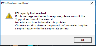

Hi
Ok as for now Scope 7 see all 24 DSP
But i keep getting this message from Scope 7
DAW in use Cubase 10 pro
No other pci card on my Motherboard and using AGP for display adapter. Hyperthreading disabled turbo boost disabled !
Can anyone help, please ?
Thanks.
Best,
Re: Best mobo and cpu combo
Posted: Tue Jun 11, 2019 8:47 am
by @plonter
Hi
I can add 3 verbals
1 - This win10 installation came from my old system, i can easily install new system...but see how the two verbals came into place..
2 - Can it be possible that Nvme ssd take a high PCI bandwidth? and this is why i get this message?
3 - For now im testing a new installation of win 10 but on a SATA SSD, but no major vst plugins are installed! and the project is light, and i don't get the message! is vst load and PCI bandwidth related?
Posted: Tue Jun 11, 2019 9:59 am
by Bud Weiser
@plonter wrote: Tue Jun 11, 2019 8:47 am
Yes, it´s POSSIBLE but doesn´t happen on every system.
WHEN you have the OS installed on p.ex. a NvME M.2 SSD, it might act as a PCIe bus hog because there´s traffic always.
A OS is a busy application.
@plonter wrote: Tue Jun 11, 2019 8:47 am 3 - For now im testing a new installation of win 10 but on a SATA SSD ... and i don't get the message! is vst load and PCI bandwidth related?
You´re on the right way IMO.
SATA SSD is fast enough for OS ...
Now use NvME M.2 for sample streaming.
Posted: Tue Jun 11, 2019 11:01 am
by @plonter
Hi
Thanks for the reply.
Ok just made a fresh install of win10 on Nvme hdd and loaded same vst plugins to a project and no PCI bandwidth message :)
I left the project on loop for about 20 mintes and came back and he is playeing witout messages :)
Cross my fingers now.
What else can do to check stabelty ?
Posted: Tue Jun 11, 2019 2:48 pm
by astroman
I also had 3 cards connected by a single cable without problems for years.
The PCI bandwidth error is a different case:
the card has to access the PC's main memory for Asio streams etc, but also for data it cannot store locally, which applies to long delays and reverb in the first place. Reverb is the main PCI hog in Scope.
Posted: Thu Jun 13, 2019 11:27 am
by @plonter
Hi
No metter what i do i keep receiving the PCI-Master-Overflow!
This is my Motherboard: Asus TUF H310-PLUS GAMING.
With CPU as a graphic adapter or with Nvidia card, with Nvme no Nvme or even with 2.5 SSD
for a day and half, everything was working great then i closed scope 7 reopen Scope 7 and got the message no hardware found after this i restarted my PC and this PCI-Master-Overflow came up and do not disappear :(
Any advice? maybe win 7 can do a better job?
Posted: Thu Jun 13, 2019 11:41 am
by @plonter
Update, now that i take out the Scope/sp out of the system the message didn't appear!
Now this system compiled with 2 Luna cards and one Pulsar 2 card, why this 15 DSP card causing so much trouble?
All my new build around this Asus Motherboard was to have 3 PCI slots before i was working with a z390 motherboard with 2 Luna cards and one Pulsar 2 card for almost a year even with PCI to PCIe adapters and everything was fine...
I switched to this Asus board because the z390 with PCI to PCIe adapters also had problems with the Scope/sp card but a different kind, a message about Violations something!
Posted: Thu Jun 13, 2019 1:10 pm
by @plonter
Hi
Can it be that high asio port causing my PCI to overflow?
I have just lowered it to 32 from 64 and no message......
Posted: Thu Jun 13, 2019 3:00 pm
by Bud Weiser
@plonter wrote: Thu Jun 13, 2019 11:41 am Update, now that i take out the Scope/sp out of the system the message didn't appear!
When you choosed "outdated" Z97/socket 1150 technology,- all the discussion would be obsolete (IMO).
You own PCI cards from about 1999 or 2000+,- and NOW, you want to use the latest/greatest PC hardware w/ these cards ...
It´s not all matter of SCOPE software,- you have to accept that support of legacy PCI cards is more or less over.
That doesn´t mean S|C is the culprit,- but Microsoft and others moved on and don´t even know there are Creamware card legacy users.
And even they did, they won´t care !
And now, please don´t complain,- I myself own a 15DSP SCOPE card in addition to XITE.
But,- XITE is the way to go for future.
It´s not perfect up to now, but it will be the only S|C hardware product being supported for next future and until they will come up w/ another one.
Posted: Thu Jun 13, 2019 3:18 pm
by @plonter
Hi Bud
Sorry for my confusion,
Yes, the fresh install is on A NvMe SSD M.2, this was working for almost two days! as for now, i managed to set 3 cards again no change to the M.2 NvMe SSD, and no Overflow....at first of all one key change i made is lowered the ASIO to 32 ch!
BUT Now please see this :) from my reading in our forum :)
1 - As i understand there is some issues with 1st gen PCI card along with 2st gen.
And the key change taking is leading to 2...
2 - As i understand one of the PCI cards act as a Master, so a suggestion made to set a 2st gen as master in a mix if 1st gen + 2st gen, and a way to make sure is that the first card (2st gen) is first in the list of DSP count, so i did set Luna as the first one by changing PCI position to the one closer to the CPU and Pulsar 2 in the middle and in the end Scope/sp.
( only thing is that i get this form " Scope + Pulsar 2 + Luna" in the headline!
But at the DSP count is see Lune in first place, is luna a 2nd gen PCI card? i know for sure that Pulsar 2 is..
3 - Also read that a Device validation can cause PCI-Mastesr-Overflow, this is very close to my last PCI Overflow meaning i did add new Device and Scope 7 asked for a KEY...
4 - Plusar 2 is 2nd gen PCI card , Luna is ? , Scope/sp 15 DSP is ?
mmmm..... :)
am i ? :)
Posted: Thu Jun 13, 2019 4:30 pm
by garyb
a first generation card will ALWAYS reduce the available PCI bandwidth.
making one card the master will make no difference, except for latency.
