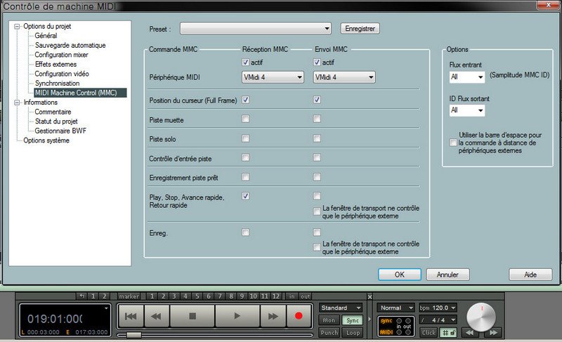

What is your experience with SamX3 and scope ?
I had some lockups of sam, which I try to understand. ( Using Midi-clock to control a slaved samx3)

Using cubase since more than 20 years, of course, it's a bit hard to change. Reaper didn't convince me and to me, samplitude not much more. I've found even less feature to help my workflow than in reaper !
Except that, I didn't noticed issue with Scope. The best way I've found to control sam as slave are like this in sam (don't know what is your master but I could show you wich cubase setting I used). Just midi clock was not really good... MMC is much better ! Vmidi I/O are from Copperlan. For sync options :

It's in french but option places are the same... And MMC options :

Re: Magix Samplitude Pro Xmas Offer
Thanks for your setup picture.
I also used cubase since 20 years, but just as a "stupid tape". All my magic happened within scope.
SamX3 is not planed to replace scope, but to do the "stupid tape" job as reliable as good old cubase did.
My reliablilitytests show, that the goal is not reached yet.

salut j'ai tout compris au mmc de samplitudeJoPo wrote: Sat Feb 03, 2018 6:54 am It's in french but option places are the same... And MMC options :
avec ca tu peux diriger le play le stop d'un autre sequencer ou d'une mpc 2000
faut juste que tu affecte les port midi in et out
mais la synchro mmc marche très mal sur samplitude

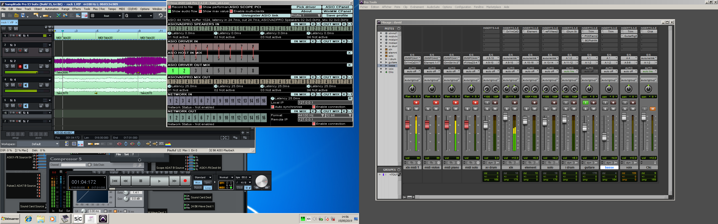

hello
just try and see how working linked asio scope with asio deus pro
for me scope 5 work far better with this link
1024 samples latency is not a problem because i use protools HD for plugins
and asio direct monitoring allow record without latency even at 1024
but when you plays vst at 1024 in samplitude vst delay tempo are sync
cheers
cheers
- asio scope 5 asiolinkpro ASIO DEUS.png (441.81 KiB) Viewed 8776 times
